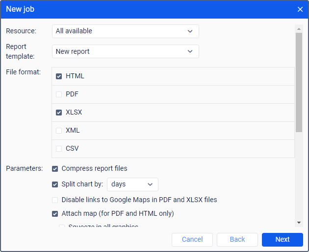

To create a job of this type, follow the guide to creating jobs. In step 4, specify the parameters described below.
The required parameters are marked with an asterisk (*).
Parameter Description
Resource* In the drop-down list, select the resource in which the required report template is stored. To see templates from all the available resources, select the All available option.
Report template* Select the required report template. The list shows only those templates that belong to the selected resource.
File format* Select one or more file formats: HTML, PDF, Excel, XML, CSV. When you select the PDF format, you can specify the page orientation, size, and width. If you select the CSV format, you can specify the coding and delimiter, and enable or disable the display of column headers. Read more about report formats on the Exporting report to files page.
Parameters Specify additional report parameters. They are similar to the parameters that are available when exporting a report to a file.
Interval* Specify the time interval for which the report should be generated. See the examples of configuring the interval to receive daily, weekly, and monthly reports.
Content* Select one of the two options which determine the report content:
  • the Send files/archives option allows sending files or archives directly to the specified email addresses;
  • the Send links to files/archives option allows sending links to an FTP server (Wialon Lite or custom server) where the report files or archives are stored.
Recipients* Specify the email addresses of the report recipient. To do this, activate the fields and enter the required addresses. After filling in the last field, a new one is added automatically.
