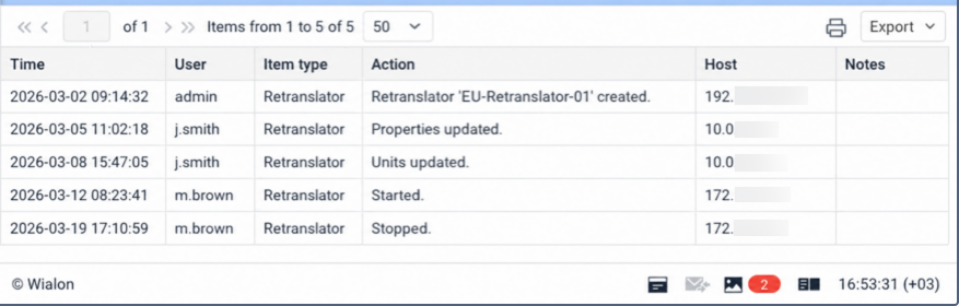

The Log table contains records about changes made by users in the properties of the retranslator or its contents. Unlike the log of the monitoring or management system, the report doesn’t show records about errors, receiving messages from a unit, and so on.
You can add the following columns to the Log table:
Column Description
Time The time of making (saving) the change.
User The name of the user who made the change. In order for the report to show only changes made by a specific user, specify their name or name mask in the filter of the table settings.
Item type The type of the object the properties or contents of which were changed. The only possible type is a retranslator.
Action The description of the change made.
Host The address of the computer (device) from where the user made changes or from where the job or notification configured by them was triggered.
Notes An empty column where you can leave your own comments after printing or exporting the report.
