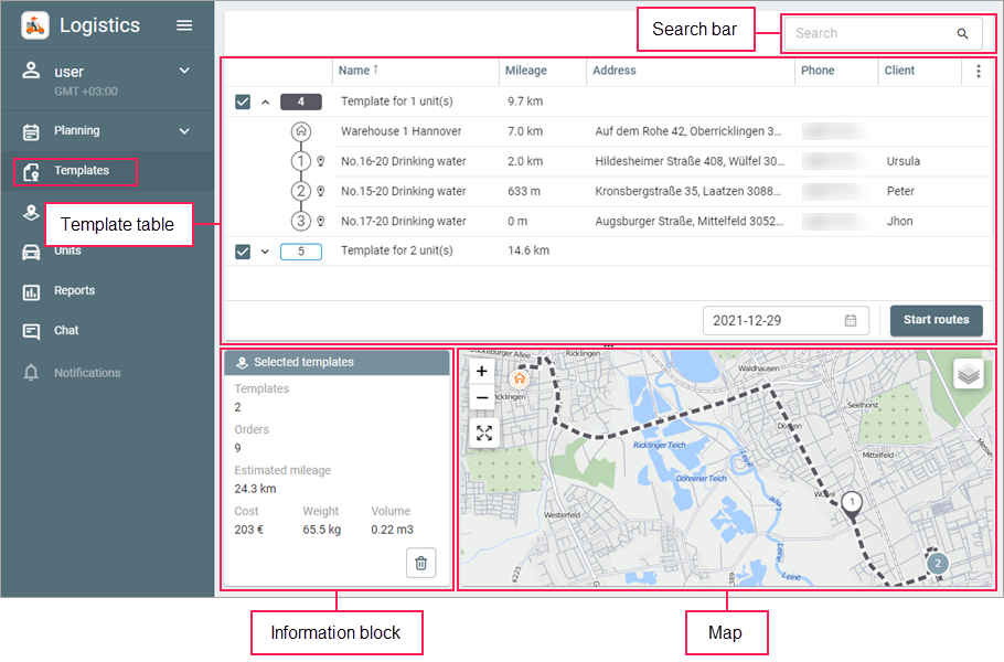

This page displays templates for creating routes. You can use them if you should create similar routes regularly. A template stores information about the route points and the assigned unit.
The Templates page consists of the following components:
  • table;
  • information block;
  • map;
  • search bar.

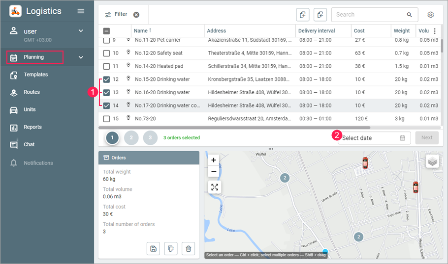

  1. On the Planning tab, select the orders you want to include in the template.
![](/en/spaces/logistics/versions/wialon_local_2604/user-guide/assets/templates1_en.png)

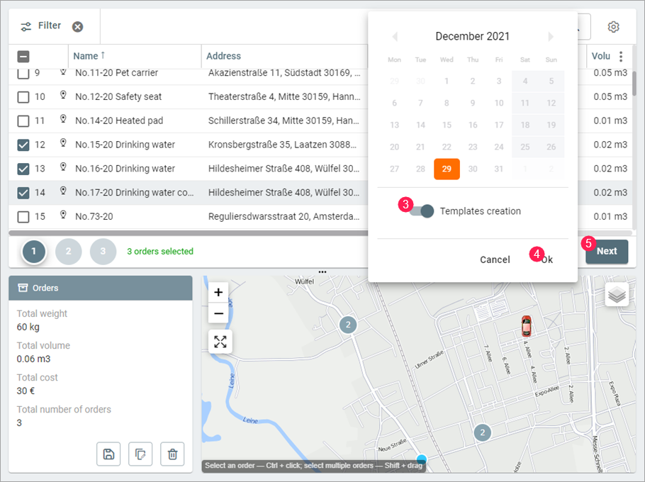

  1. Open the calendar (the icon).
  2. Activate the Template creation switch.
  3. Click ОК.

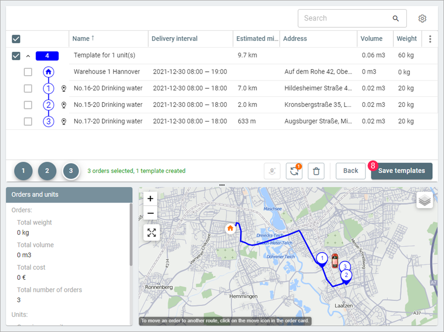

  4. Click Next to go to the following planning stage.

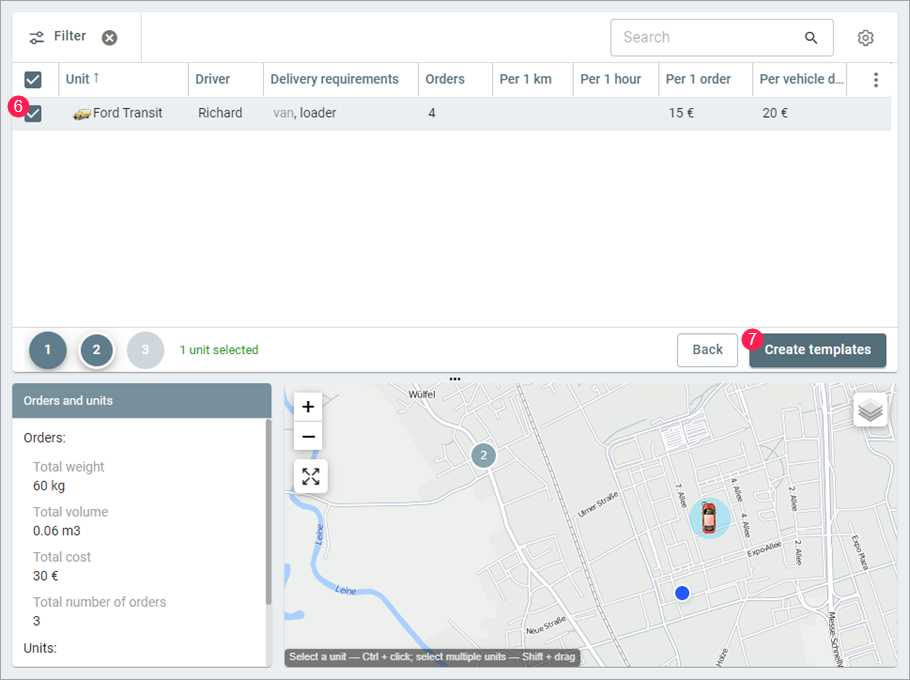

  5. Select a unit or units.
  6. Click Create templates.
  7. Save all or separate route templates.

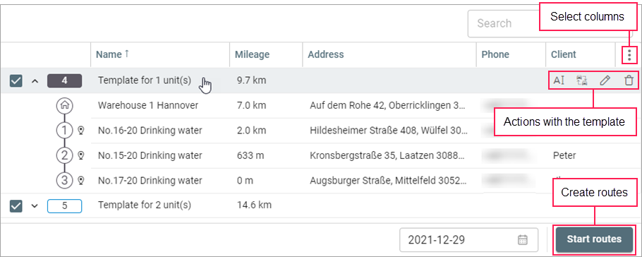

If you point to a line with a template in the table, the following actions become available:
IconActions
Rename the template.
Change the unit that should fulfil the route.
Change the template (add, delete orders or change their sequence).
Delete the template.
The same actions are available in the information block.
To create a route on the basis of a template, select it in the table, choose a date and click Start routes. After that, the route will appear on the Routes page among the planned or active routes.
