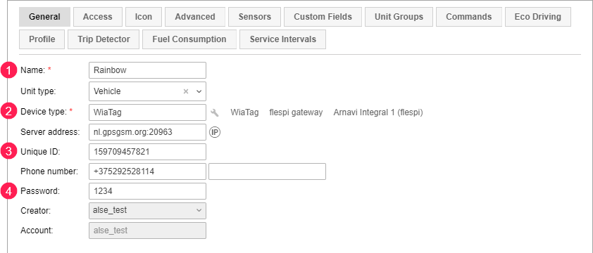

Creating a unit in Wialon
When creating a unit in Wialon, you should specify the unit properties which are described in detail in the Wialon Hosting and Wialon Local user guides. The table below shows the properties which are directly related to Configurator and WiaTag operation.
PropertyDescription
NameIndicate the unit name (4 – 50 characters). Avoid using forbidden characters. The indicated name will be displayed in the unit list in Configurator and in the mobile application after authorizing with a username.
Device typeSelect WiaTag as the device type.
Unique ID
Enter the unique identification number (ID) of the device. It is required for connecting the device to WiaTag and identifying the unit in the monitoring system. You can use any combination of numbers and letters up to 100 characters (for example, the IMEI of the mobile device).
PasswordSet a password for access to the unit (optional). The password is used when signing in to the mobile application with the unique ID of the unit.
