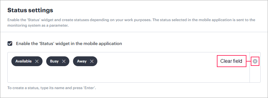

Status settings
In this section, you can activate the Status widget for the mobile application and create statuses which the WiaTag user can send.
Activate the Enable the ‘Status’ widget in the mobile application option in order for the Status widget to be displayed in WiaTag. In the field below, add statuses which the WiaTag user can select. The ones added by default are Available, Busy, and Away. To create a new status, type its name and press Enter. To delete a status, click on the icon   next to its name. A click on the icon   clears the entire field.
If you have created statuses for the devices of the selected units earlier, then those that are the same for all the devices have a black background, and those that don’t coincide have a white one. When you click on a status with a white background, it becomes black and, after installing the configuration, it is added for all the devices. The statuses with a white background remain in the configuration of the devices for which they have been created. If you want to delete them, click on the icon .
