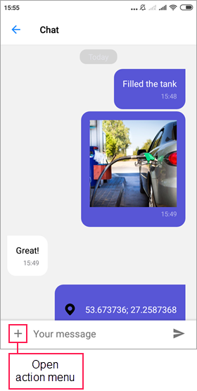

Chat | The function allows sending a text message to the Wialon server. In addition, you can send photos, QR codes, alarm messages, and coordinates if the widgets corresponding to these actions are activated for the device.![]() To send a text message, tap the widget, enter the message text and tap the icon . To send a different type of message, tap the icon and select the required action:
The message history is shown in the chat window. After a long tap on a message, a menu opens which allows you to delete or copy the message. To delete or copy several messages at once, select them and tap the required option in the menu. If there are unread messages, their number is displayed in the chat widget. |
: send a photo from the camera;
: send an image from the gallery;
: send a QR code;
: send an alarm message;
: send coordinates.
