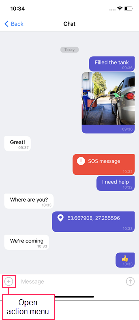

Chat The function allows sending a text message to the Wialon server. In addition, you can send photos, QR codes, alarm messages, and coordinates if the widgets corresponding to these actions are activated for the device.
To send a text message, tap the widget, enter the message text and tap the icon . To send a different type of message, tap the icon and select the required action:
  • Camera: send a photo from the camera;
  • Gallery: send an image from the gallery;
  • Location: send coordinates;
  • QR code: end a QR code;
  • SOS messages: send an alarm message.
The message history is shown in the chat window. After a long tap on a message, a menu opens which allows you to delete or copy the message. To see a sent location on the map, tap the message with coordinates and select the map: Apple Maps or Street View.
If there are unread messages, their number is displayed in the chat widget.
