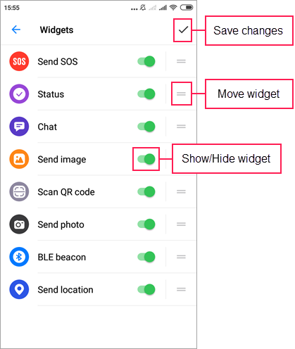

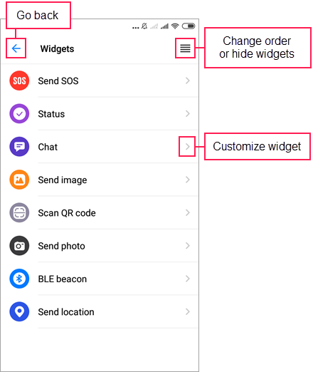

In this section of settings, you can change the size and order of widgets, hide them or configure additional settings for them.
To change the order of widgets or hide them, tap the icon . Drag the widgets by holding them by the icon  or hide them using the switch. To save the changes, tap the icon .
To go to the settings of a certain widget, tap the line with it. Here you can hide the widget using the switch or change its size by selecting the required option in the Select widget size block.
You can configure additional settings for some widgets.
