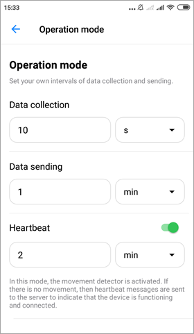

Operation mode
In this section, you should specify the frequency of collecting and sending positional data and, if necessary, enable the heartbeat mode.
The available settings are described below.
Setting
Description
Data collection
In this field, specify the frequency at which positional points should be generated. In the drop-down list on the right, select the unit of time (seconds or minutes). The lower the specified value, the more accurate the data. If the specified value is less than a minute, the consumption of traffic and battery power increases significantly. If the value is 0, the data is collected continuously.
Data sending
In this field, specify the frequency at which positional data should be sent to the server. In the drop-down list on the right, select the unit of time (seconds or minutes). The lower the specified value, the higher the consumption of traffic and battery power.
Heartbeat
Activate this option to specify the frequency at which heartbeat messages should be sent to the server when the unit is not moving. Such messages allow seeing only that the unit is online, and don't contain location data. In the drop-down list, select the unit of time (seconds or minutes).
If the option is not activated, the frequency of collecting and sending data corresponds to the first two options, regardless of whether the unit is moving or not.

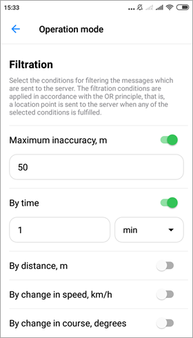

Filtration
In this section, you can configure the criteria according to which the unit messages should be filtered. The filtration allows you to avoid sending redundant data to the server and reduce traffic consumption.
Messages are filtered only when they are received by means of GPS. If the location is determined by cell towers or Wi-Fi, the messages contain zero values of speed, course, number of satellites, and the inaccuracy can exceed 2000 meters, therefore such messages are not filtered.
The filtration criteria work in accordance with the OR principle, that is, a positional point is sent to the server when a message is considered valid according to at least one criterion.
Filtration criterion
Description
Max inaccuracy
Activate this option to specify the maximum allowed inaccuracy of positional data which should be sent to the server. If the data inaccuracy exceeds the specified value, the message is considered invalid according to this criterion.
It is not advisable to specify a value less than 10 meters because, in this case, there may not be enough positional data to get accurate unit tracks.
By time
Activate this option to specify how much time should pass from the previous message in order to send a new one. In the drop-down list, select the unit of time (seconds or minutes).
The messages generated before the specified amount of time has passed are considered invalid according to this criterion.
By distance
Activate this option to specify what distance the unit should travel from the time of the previous message in order to send a new one.
The messages generated before the specified distance has been travelled are considered invalid according to this criterion.
By speed
Activate this option to specify how much the speed value should change from the time of the previous message in order to send a new one.
The messages generated before the unit speed has increased or decreased by the specified value are considered invalid according to this criterion.
By change in course
Activate this option to specify how much the course angle should change from the time of the previous message in order to send a new one.
The messages generated before the course angle has increased or decreased by the specified value are considered invalid according to this criterion.
