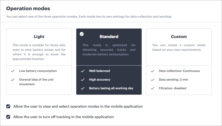

Selecting the operation mode
The operation mode influences the battery consumption and the accuracy of positional data. Select one of the available modes:
Mode
Description
Light
The mode which allows saving battery power and receiving approximate data about the location of the unit.
Standard
The mode which allows consuming battery power moderately and obtaining accurate tracks of the unit.
Custom
The mode which you can configure according to your requirements.

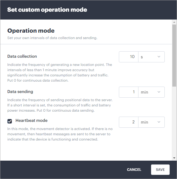

Configuring a custom mode
To configure a custom mode, click on the icon . Adjust the required settings in the Operation mode and Filtration sections, and click Save.
Operation mode
In this section, you should specify the frequency of collecting and sending positional data. If necessary, you can also enable the heartbeat mode.
The available settings are described below.
Setting
Description
Data collection
In this field, specify the frequency at which positional points should be generated. In the drop-down list on the right, select the unit of time (seconds or minutes). The lower the specified value, the more accurate the data. If the specified value is less than a minute, the consumption of traffic and battery power increases significantly. If the value is 0, the data is collected continuously.
Data sending
In this field, specify the frequency at which positional data should be sent to the server. In the drop-down list on the right, select the unit of time (seconds or minutes). The lower the specified value, the higher the consumption of traffic and battery power.
Heartbeat mode
Activate this option to specify the frequency at which heartbeat messages should be sent to the server when the unit is not moving. Such messages allow seeing only that the unit is online, and don't contain location data. In the drop-down list, select the unit of time (seconds or minutes).
If the option is not activated, the frequency of collecting and sending data corresponds to the first two options, regardless of whether the unit is moving or not.

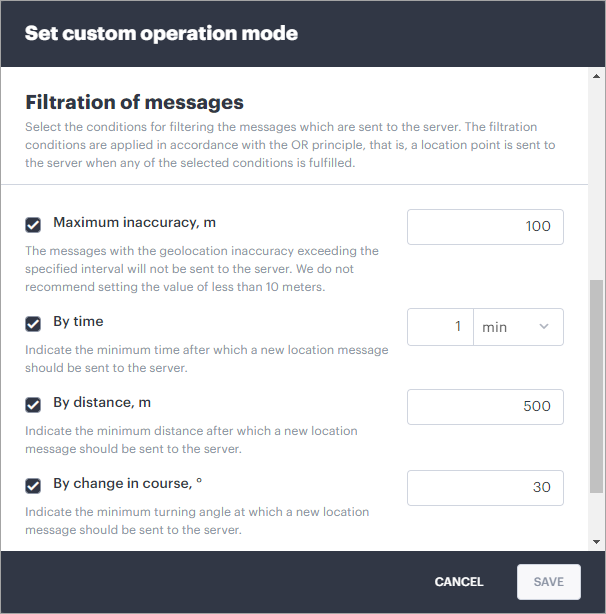

Filtration of messages
In this section, you can configure the criteria according to which the unit messages should be filtered. The filtration allows you to avoid sending redundant data to the server and reduce traffic consumption.
Messages are filtered only when they are received by means of GPS. If the location is determined by cell towers or Wi-Fi, the messages contain zero values of speed, course, number of satellites, and the inaccuracy can exceed 2000 meters, therefore such messages are not filtered.
The filtration criteria work in accordance with the OR principle, that is, a positional point is sent to the server when a message is considered valid according to at least one criterion.
Filtration criterion
Description
Max inaccuracy
Activate this option to specify the maximum allowed inaccuracy of positional data which should be sent to the server. If the data inaccuracy exceeds the specified value, the message is considered invalid according to this criterion.
It is not advisable to specify a value less than 10 meters because, in this case, there may not be enough positional data to get accurate unit tracks.
By time
Activate this option to specify how much time should pass from the previous message in order to send a new one. In the drop-down list, select the unit of time (seconds or minutes).
The messages generated before the specified amount of time has passed are considered invalid according to this criterion.
By distance
Activate this option to specify what distance the unit should travel from the time of the previous message in order to send a new one.
The messages generated before the specified distance has been travelled are considered invalid according to this criterion.
By change in course
Activate this option to specify how much the course angle should change from the time of the previous message in order to send a new one.
The messages generated before the course angle has increased or decreased by the specified value are considered invalid according to this criterion.
By change of speed
Activate this option to specify how much the speed value should change from the time of the previous message in order to send a new one.
The messages generated before the unit speed has increased or decreased by the specified value are considered invalid according to this criterion.
Granting permissions
You can give the following permissions to the WiaTag user:
PermissionDescription
Allow the user to view and select operation modes in the mobile application
Activate this option so that the WiaTag user can select the operation mode as well as configure a custom one in the mobile application. If the option is not activated, the Operation mode section is not displayed in the mobile application settings.
Allow the user to turn off tracking in the mobile application
Activate this option so that the WiaTag user can disable sending positional data to the Wialon server. If the option is not activated, then when the device is online, the data is always sent to the server according to the selected mode and work on schedule (if configured).
