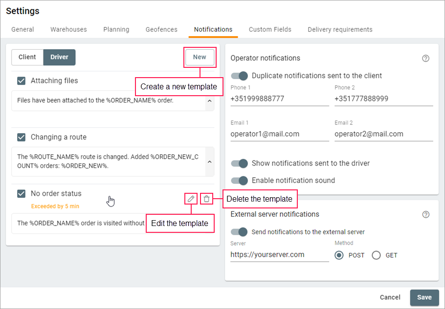

Driver notifications
The driver notifications are displayed in the mobile application as push notifications.

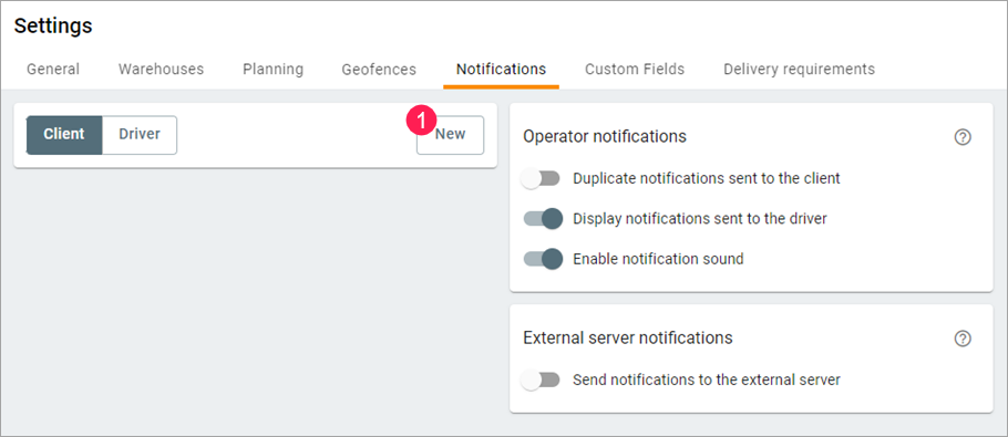

Notification template creation
To create a notification template, follow the steps below.
  1. Click New.
  2. Select the notification type.
  3. For the Time left until the delivery and Orders ready to be sent notifications, specify the time, for the Distance to the delivery point notification, specify the distance.
  4. Type the text for the name and contents of the email and/or SMS message using the tags which will be substituted for real values in the sent notification. Click HTML or Text to select the message view mode.
  5. Save the changes.
