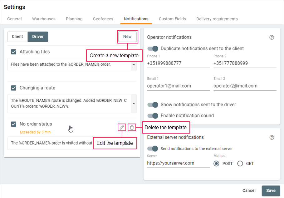

Client and Driver Notifications
In this section, you can create the templates of client and driver notifications and configure their sending. Depending on the switcher state, the section shows the created templates of client or driver notifications.
Below are the available types of notifications.

Notification template creation
To create a notification template, follow the steps below.
- Click New.
- Select the notification type.
- For the Time left until the delivery and Orders ready to be sent notifications, specify the time, for the Distance to the delivery point notification, specify the distance.
- Type the text for the name and contents of the email and/or SMS message using the tags which will be substituted for real values in the sent notification. Click HTML or Text to select the message view mode.
- Save the changes.
In order for the email message text to be displayed correctly, the receiver should enable the function of viewing emails in HTML.
