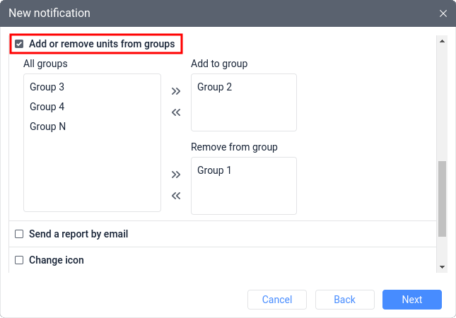

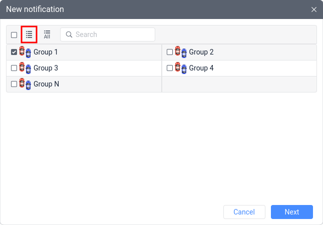

notifications can monitor not only specific units but also groups of units;
notifications allow adding or removing units from groups.
By combining these features, non-obvious behavior can be achieved:
- If you set up a notification to monitor an empty group, the notification will be enabled, but will not trigger because there are no units in the group.
- If you add units to this group, even without changing the notification settings, it will automatically start monitoring the added units.
- If you remove units from the group, the notification will automatically stop monitoring them.

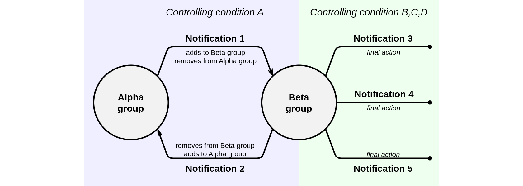

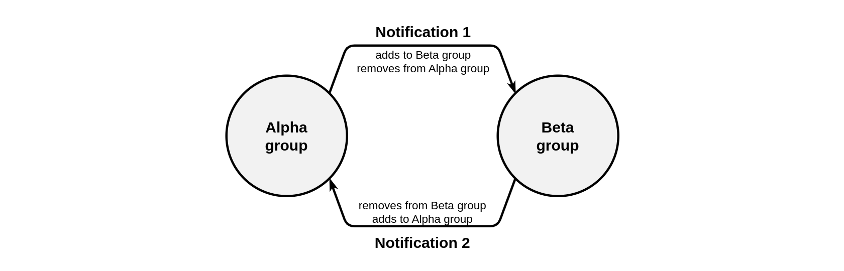

To sort by one condition A, the following elements and settings will be required:
- The Alpha group that contains units the condition A has not yet been met for.
- The Beta group that contains units the condition A has been met for.
- Notification 1 which is configured to monitor the Alpha group and control condition A. If this condition is met, the units will be removed from the Alpha group and added to the Beta group.
- Notification 2 which is configured to monitor the Beta group and control the condition opposite to condition A. If this condition is met, the units will be removed from the Beta group and added back to the Alpha group.

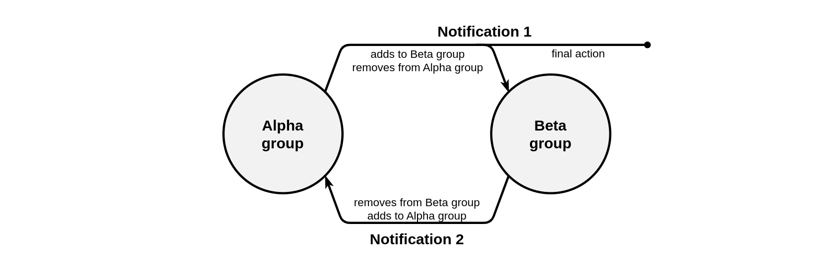

Schematically, this approach can be represented as follows:

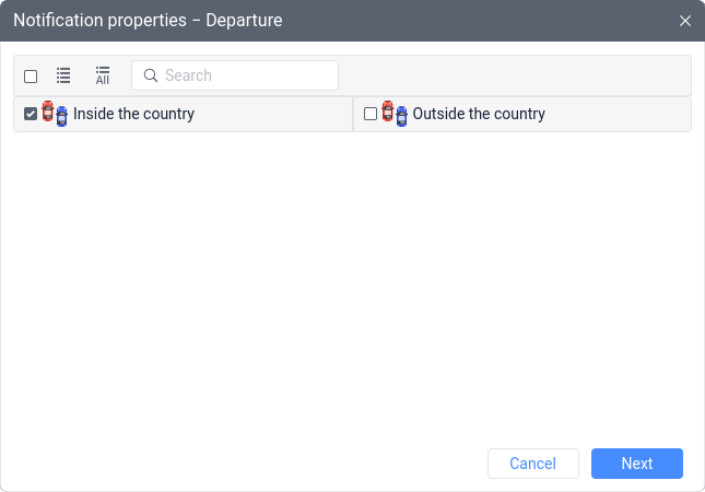

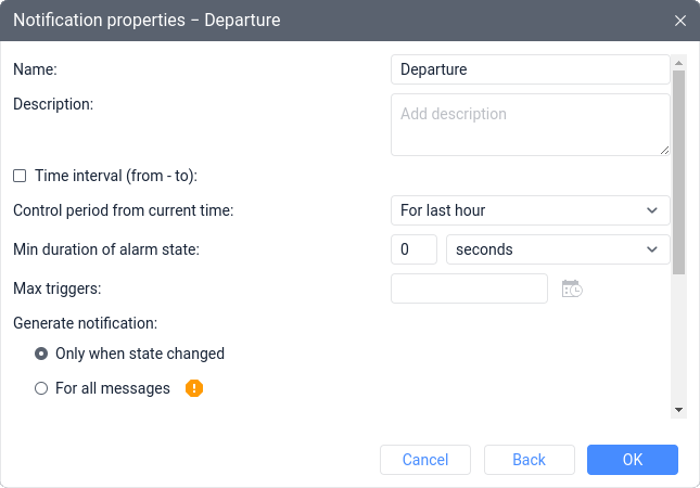

Next, it is necessary to set up the first notification called Departure, which will monitor the Inside the country group. It will control the presence of units outside the geofence. As the action, you should select the Add or remove units from groups action, namely to remove units from the Inside the country group and add them to the Outside the country group.

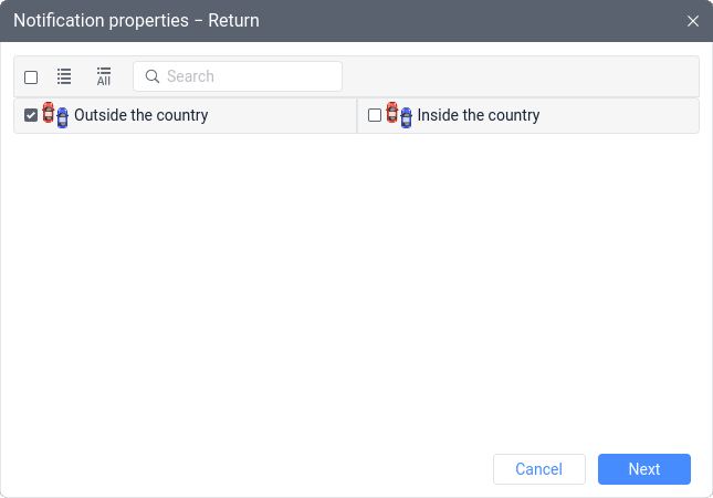

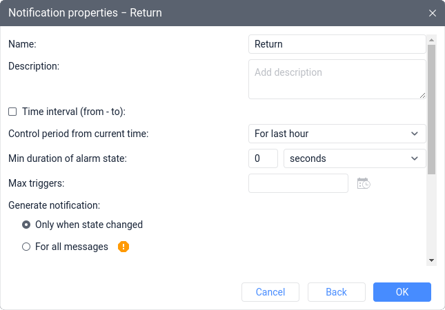

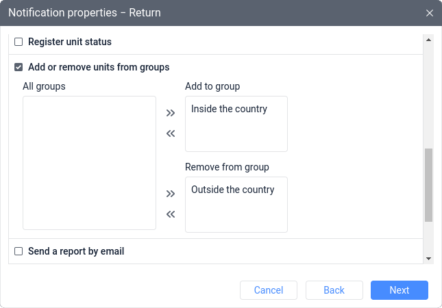

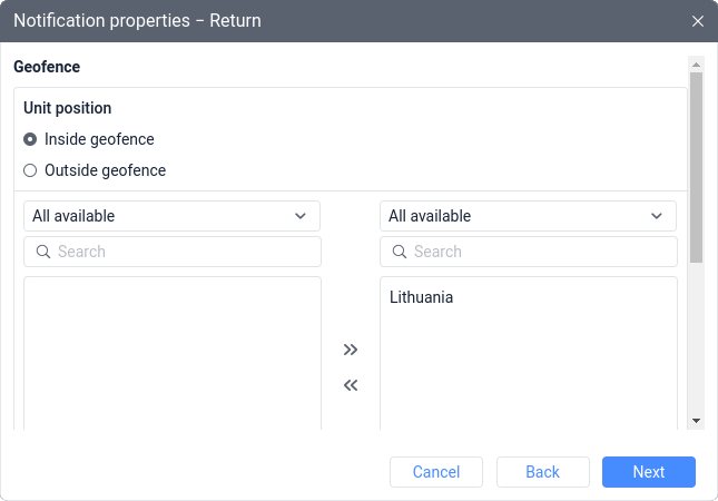

The second notification will be called Return and monitor the Outside the country group. It will control the presence of units inside the geofence. As the action, you should select the Add or remove units from groups action, namely to remove units from the Outside the country group and add them to the Inside the country group. As can be easily noticed, settings of the second notification are opposite to the first.
Now the units will dynamically move to the correct groups. Dispatchers will be able to execute a report on either the Inside the country or Outside the country group at any time, depending on their needs.

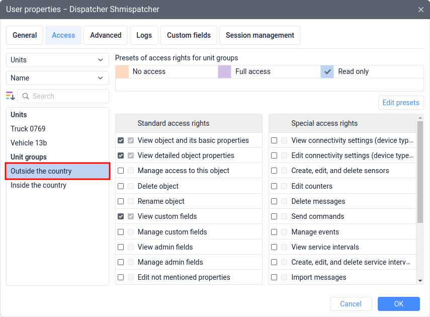

Example 2. Distribution of access through the groups
Let’s suppose that a client’s request is similar to example 1, but additionally, it is necessary to ensure that a specific dispatcher has access only to those units that are currently outside the country. The solution from the previous example will be taken as a basis, and only the missing settings will be considered below.
There are two ways to approach this solution. On the one hand, you can configure the notification so that it not only moves units between the groups but also changes access to these units. On the other hand, you can provide access to the units through the groups. Only the latter method is described below.
First, it is necessary to make sure that the dispatcher does not have access rights regarding the given units. Then it is necessary to provide the dispatcher with access rights only to access a specific group of units (in this example it is the Outside the country group).
Now, when leaving the geofence and triggering the notification, the units will be added to the Outside the country group, so the dispatcher will be able to see them. When entering the geofence, the opposite situation will occur: the notification will remove those units from the Outside the country group, so the dispatcher will not see them.

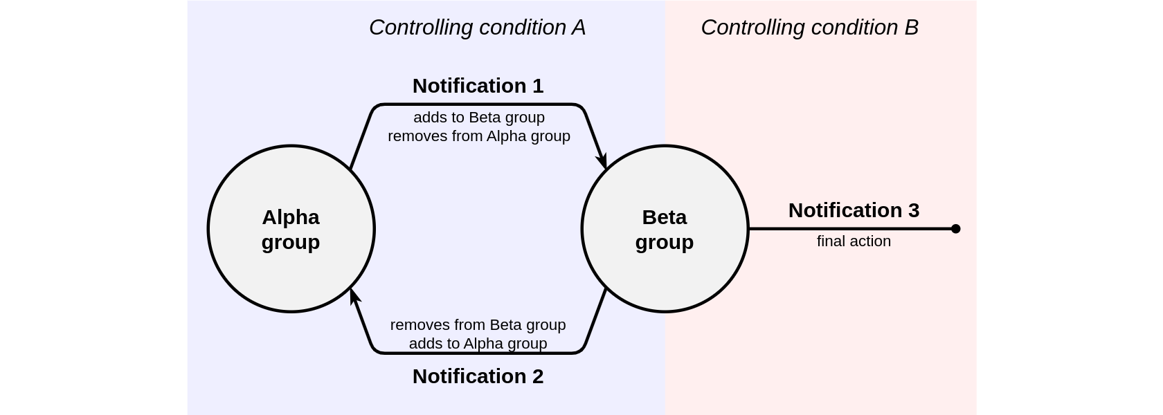

To control two conditions — A and B, the following elements and settings will be required:
- The Alpha group which contains units for which condition A has not yet been met.
- The Beta group which contains units for which condition A has already been met.
- Key notification 3 which is configured to monitor the Beta group and control condition B. If this condition is met, the notification will perform the final action (for example, notify the client by email).
In this scheme, it is possible to manage without the Alpha group, however, based on practice, the presence of this group simplifies configuration and scalability in the future. E.g. if the number of monitored units is increased, you just need to add them to the Alpha group.

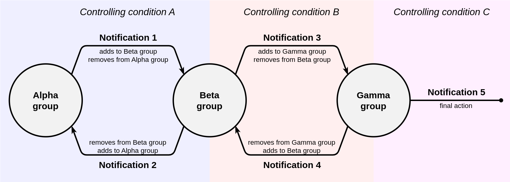

If it is necessary to control more conditions, the number of groups and notifications can be increased, for example:
The distinctive feature of this approach is the sequential control of conditions. For example, the Speed type notification with an additional Sensor value filter controls the fulfillment of both conditions simultaneously (one message is required for the notification to trigger). A notification system with dynamic groups configured for these same conditions first controls the speed and only then the sensor value (i.e., two messages is required for it to trigger). At the same time, increasing the number of elements in the scheme will also increase the number of messages required for triggering.

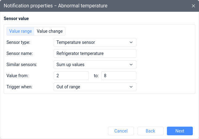

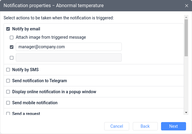

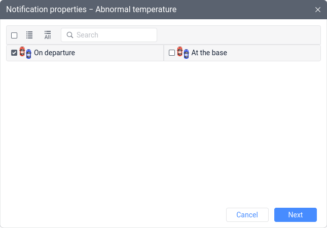

Let’s suppose a manager wants to receive information about violations of the temperature regime of refrigerator trucks that have left the base.
To solve this problem, it is first necessary to create a geofence that corresponds to the base, as well as two unit groups, which can be named At the base and On departure. Next, it is necessary to create two notifications to sort units by the created groups. You can do it similarly as the solution in the example 1. Below, only the settings for the last notification will be shown.
For temperature control, another notification called Abnormal temperature will be needed, which will monitor the On departure group. As an action, this notification will send emails to the manager.
As a result, the units will dynamically move into the appropriate groups, and temperature control will only occur outside the base.

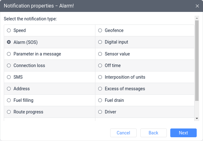

Let’s suppose a client wants to receive an SMS about the first press of the panic button for all vehicles in the fleet during the working day.
To solve this task for one unit, it is necessary to set the value 1 in the Max triggers field, and then specify a time limitation for this parameter from 00:00 to 23:59. If there are not a lot of units, you can create one notification for each of them. However, if there are quite many units, dynamic groups will have to be used, and we will be discussing it further in this example.
Schematically, the solution to this problem can be represented as follows:
Consequently, the following elements and settings will be required:

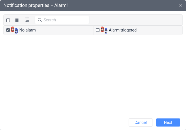

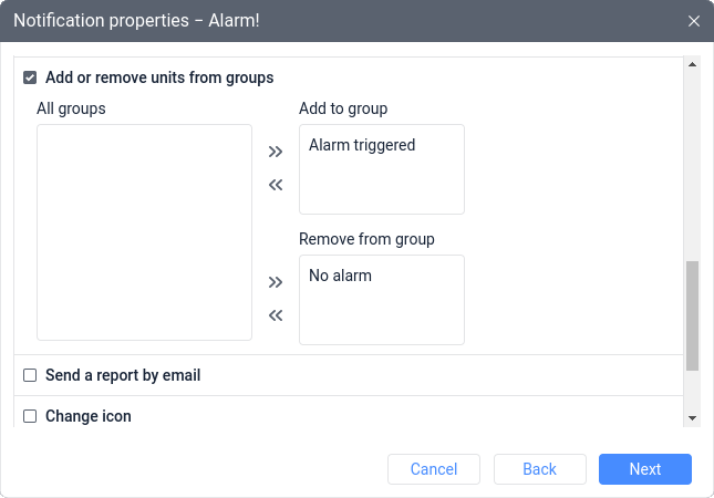

A group named No alarm (the Alpha group in the above diagram) which contains all units whose drivers have not pressed the panic button today. At midnight, all units should be in this group, so they need to be placed there initially.
A group named Alarm triggered (the Beta group in the diagram) which contains units whose drivers pressed the panic button today. This group should be empty at midnight.

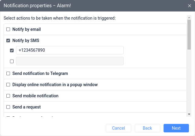

A notification named Alarm! (notification 1 in the diagram) which is set to monitor the No alarm group and control the panic button press. If this condition is met, these units will be removed from the No alarm group and added to the Alarm triggered group, and the notification will send an SMS to the client.

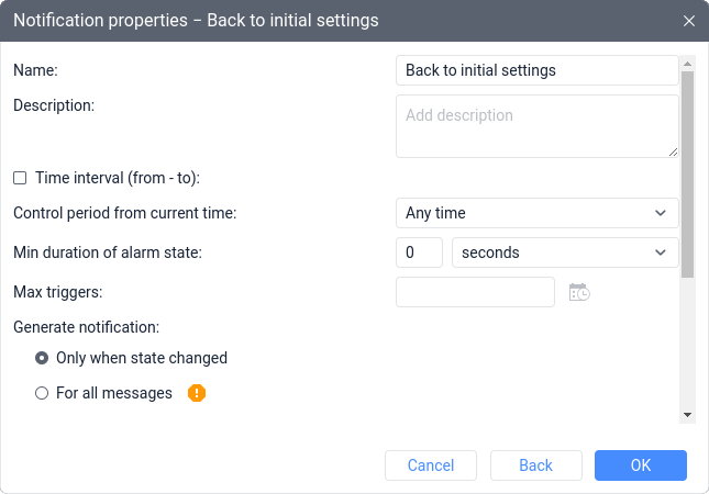

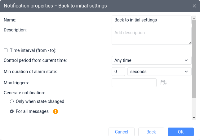

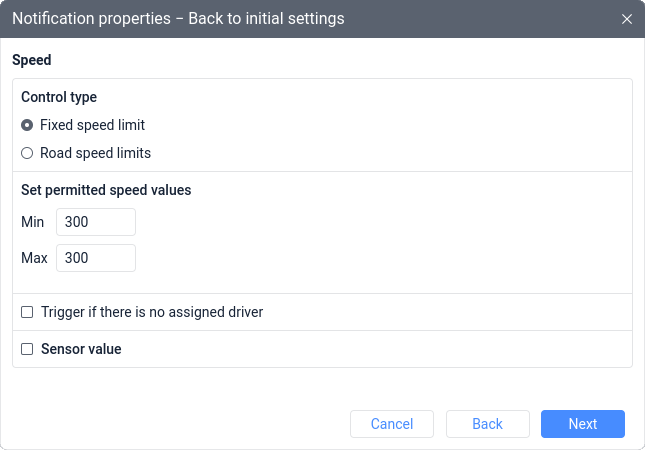

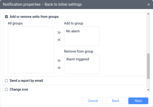

A notification named Back to initial settings (notification 2 in the diagram) in this case will return all units from the Alarm triggered group to the No alarm group closer to midnight. For this, it must be set to monitor the Alarm triggered group, have a time limitation (for example, from 20:00 to 23:59), and control some conditions that will undoubtedly be met for all the units at the end of the working day. One such condition may be a speed of less than 300 km/h (in this case, the notification should trigger For all messages).
Now, all the units whose drivers pressed the panic button will move to the Alarm triggered group at the first trigger. The control of triggering the panic button is no longer carried out for this group. Consequently, the client will only receive an SMS about the first alarm for each unit. In the evening, all units will be returned to the initial group.

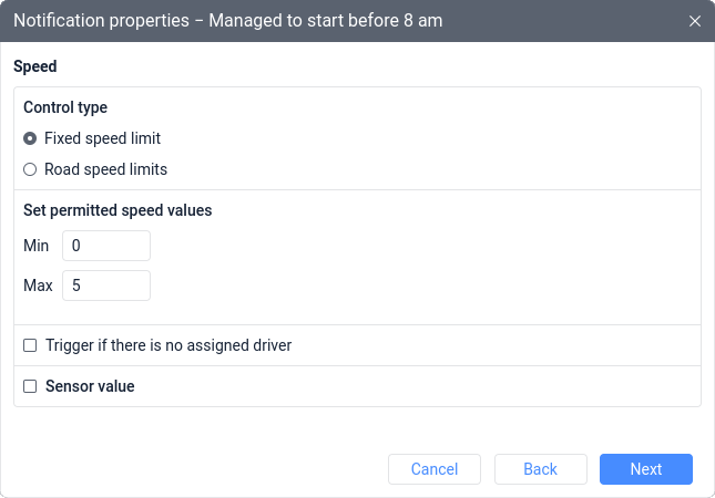

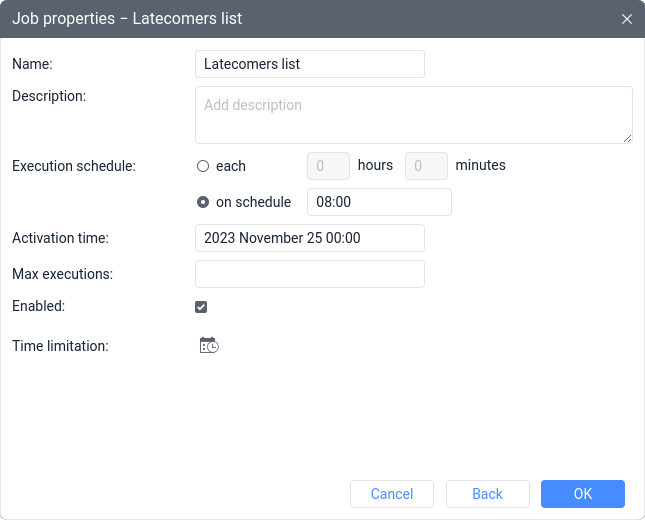

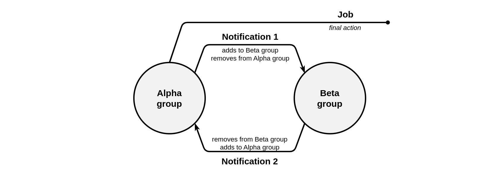

Example 5. Report on the units that have not started moving by a certain moment
Let’s assume an owner of a fleet wants to receive a daily list of vehicles that have not started moving by 8 am.

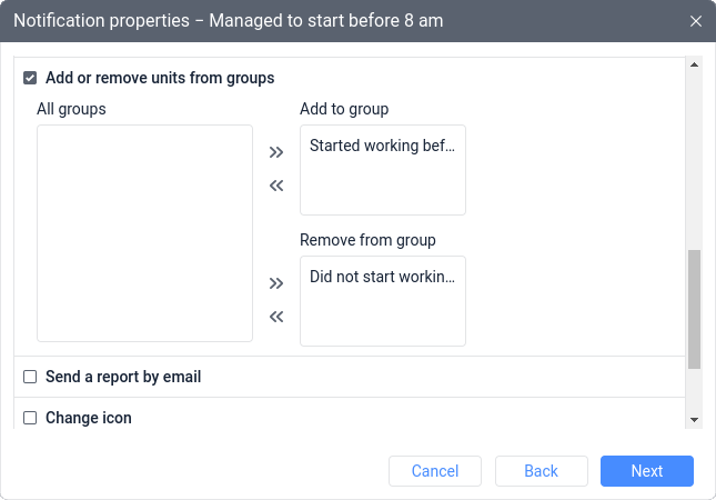

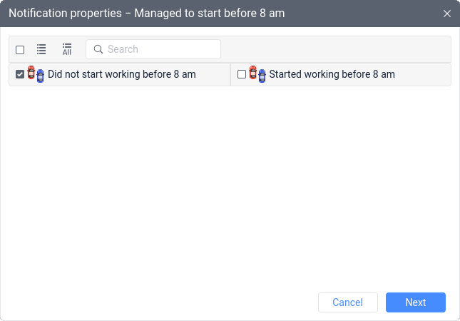

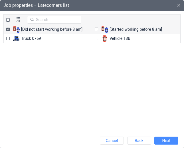

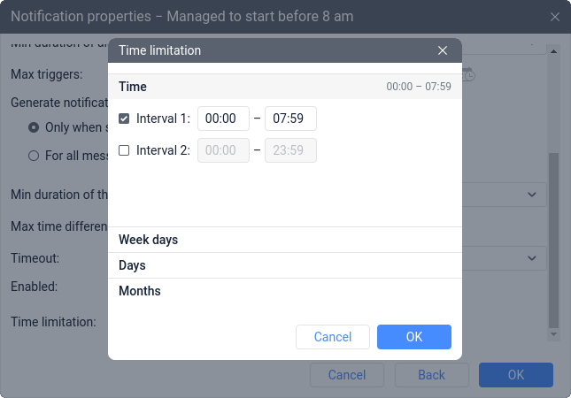

A group named Did not start working before 8 am (the Alpha group in the above diagram) which will contain all units that have not yet started moving. It is assumed that at midnight, all units in the fleet should be in this group, so they need to be initially placed there.
A group named Started working before 8 am (the Beta group in the diagram) which contains units that have already started moving. At midnight, this group should be empty.
A notification named Managed to start before 8 am (notification 1 in the diagram) which is set to monitor the Did not start working before 8 am group and control the appearance of speed (meaning, the start of work). If this condition is met, the units will be removed from the Did not start working before 8 am group and added to the Started working before 8 am group. Also, the time limitation of this notification should be set from 00:00 to 07:59.

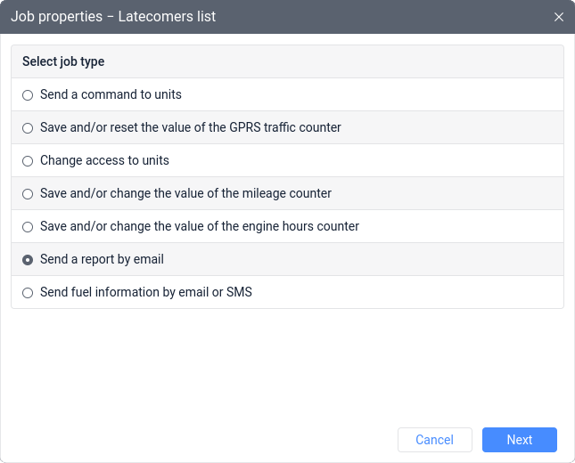

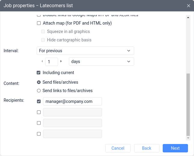

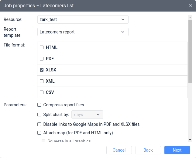

A job named Latecomers list, which at 08:00 will send a report to the owner of the fleet about the units from the Did not start working before 8 am group. The group report may contain, for example, the Unit latest data table.

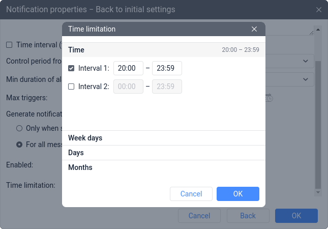

A notification named Back to initial settings (notification 2 in the diagram) in this case will return all the units from the Started working before 8 am group to the Did not start working before 8 am group closer to midnight. This is done by analogy with the similarly named notification from example 4 above.
Now, all the units that have not started moving by 08:00 will remain in the Did not start working before 8 am group, and then the job will send a report about them to the owner of the fleet. If any unit starts moving before 8 am, it will be moved to the Started working before 8 am group, so it will not be included in the report about violations. In the evening, all the units will be returned to the initial group.

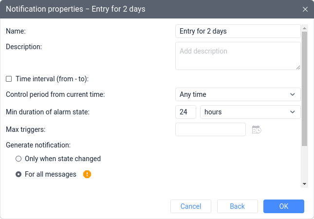

Usually, the duration of the controlled alarm state (in this case, being in a geofence) is set through the Min duration of alarm state field on the last page of the notification settings. The maximum value for this field is 24 hours (1440 minutes, 86400 seconds). In other words, it is not possible to control an alarm state lasting 72 hours without using dynamic groups.
There are two exceptions: Off time notification has a maximum duration of 30 days, and Connection loss notification has a maximum duration of 999,999 minutes (or approximately 694 days).

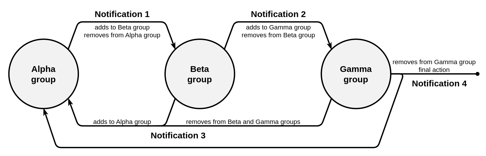

A geofence that corresponds to the factory area.

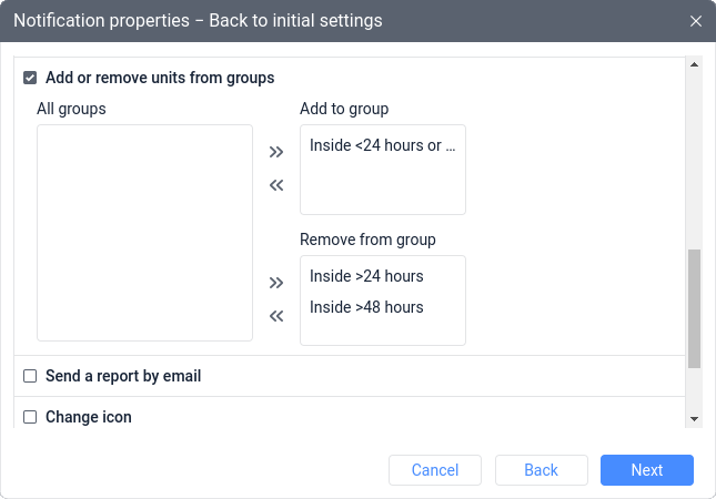

A group named Inside <24 hours or outside (the Alpha group in the above diagram), which initially contains all units.
A group named Inside >24 hours (the Beta group in the diagram) which will contain units that are inside the geofence for 24 hours or more.
A group named Inside >48 hours (the Gamma group in the diagram) which will contain units that are inside the geofence for 48 hours or more.

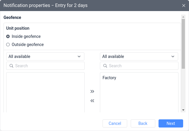

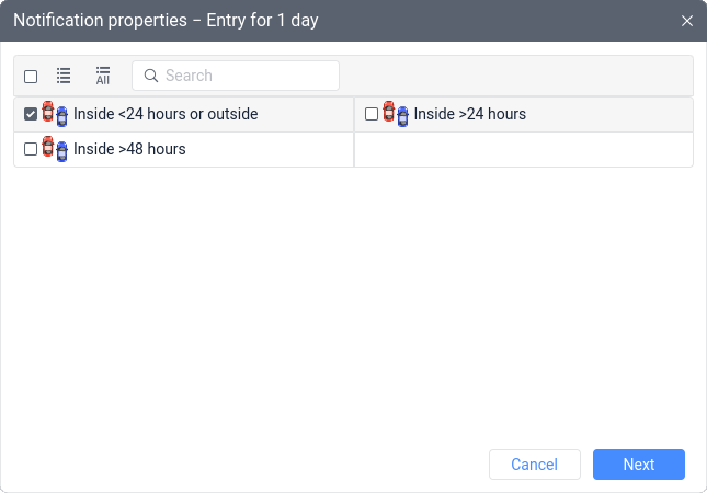

A notification named Entry for 1 day (notification 1 in the diagram), which is configured to monitor the Inside <24 hours or outside group and control a unit being inside the geofence for more than 24 hours. If this condition is met, the units will be removed from the Inside <24 hours or outside group and added to the Inside >24 hours group. The notification should trigger Only when the state changed, and the Min duration of alarm state should be equal to 24 hours (1440 minutes, 86400 seconds).

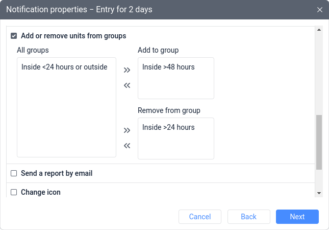

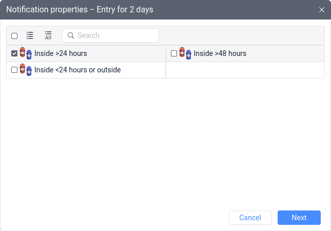

A notification named Entry for 2 days (notification 2 in the diagram) which is configured to monitor the Inside >24 hours group and control a unit being inside the geofence for more than 48 hours. If this condition is met, the units will be removed from the Inside >24 hours group and added to the Inside >48 hours group. The notification should trigger For all messages, and the Min duration of alarm state should be equal to 24 hours (1440 minutes, 86400 seconds).

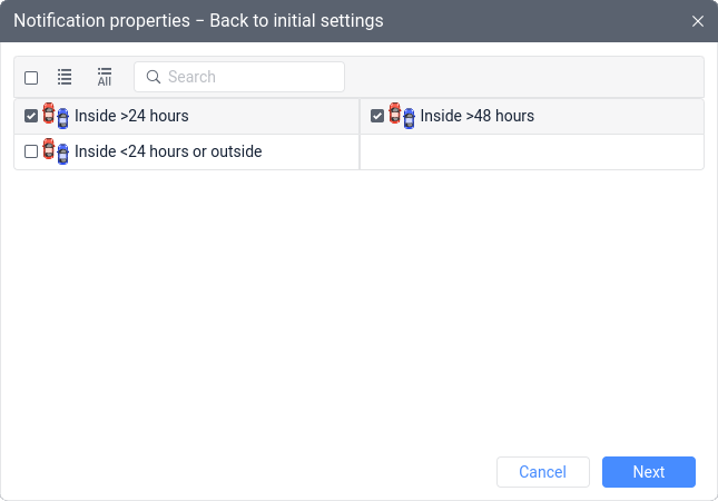

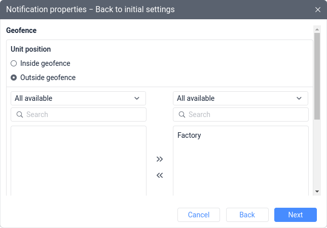

A notification named Back to initial settings (notification 3 in the diagram) will return all the units from the Inside >24 hours and Inside >48 hours groups to the Inside <24 hours or outside group if a unit leaves the geofence. The notification should trigger Only when the state changed.
In this case, all the notifications and groups are used to control one condition (being inside or outside the geofence), so unlike the previous section of this article, one notification is enough to move all the units to the first group.

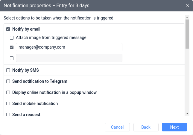

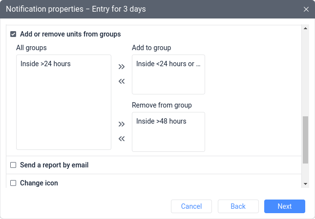

A notification named Entry for 3 days (notification 4 in the diagram) which is configured to monitor the Inside >48 hours group and control a unit being inside the geofence for more than 72 hours. If this condition is met, the units will be removed from the Inside >48 hours group and added to the Inside <24 hours or outside group and an email will be sent to the manager. The notification should trigger For all messages, and the Min duration of alarm state should be set to 24 hours (1440 minutes, 86400 seconds).
Now, all the units that have been inside the geofence for one day will move from the Inside <24 hours or outside group to the Inside >24 hours group after one day, they will move to the Inside >48 hours group after another day, and after one more day, the notification will send an email to the manager and move the units back to the initial group. If at any point the units leave the geofence, they will return to the original Inside <24 hours or outside group.
