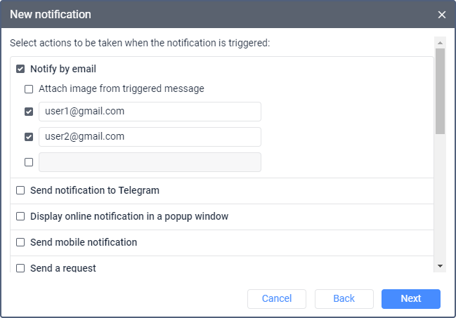

Notify by email
This action allows you to configure sending email notifications. To do this, check the box to the left of the field and specify the address to which notifications should be sent. A new field is added automatically after each input. To cancel sending notifications to any of the specified addresses, uncheck the box to the left of the required address.
Some types of devices allow you to attach to the email an image sent by the unit in the message after which the notification was triggered. To do this, enable the Attach image from triggered message option.
The notification name is specified in the header of the received email and the unit name, in brackets. The main part of the email contains the notification text. If the Unsubscribe feature is enabled in the properties of the account or resource where the notification is stored, an Unsubscribe link is shown at the bottom of the email.
If a recipient unsubscribes, the box to the left of their email is automatically unchecked in the notification settings. If all the specified recipients unsubscribe, and only this action is specified in the notification settings, the notification is automatically disabled.

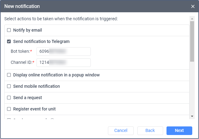

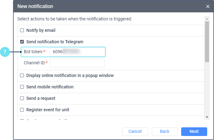

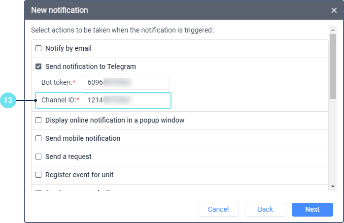

Send notification to Telegram
This action allows you to send notifications to the Telegram messenger.
Notifications can be sent to:
Notifications to the user’s private messages

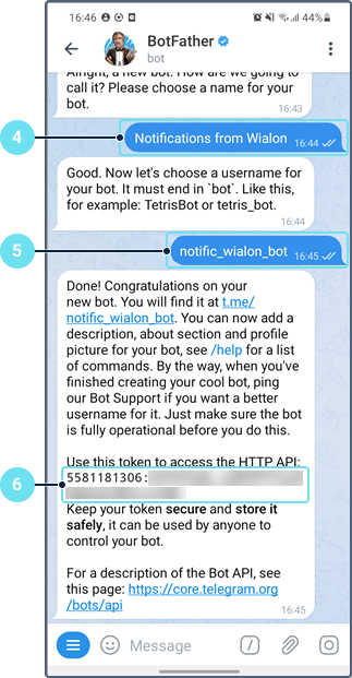

To configure sending notifications to the user’s private messages, follow these steps:

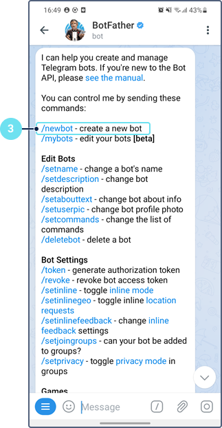

  1. Using the search, find and open the bot named BotFather.
  2. Tap Start.
  3. Select the /newbot command.
  4. Specify the bot name.
  5. Specify the user name for the bot. It should end with the word bot.
  6. Save the received token.
  7. Specify the token in the Bot token field.

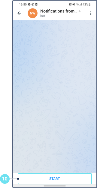

  8. Select the /mybots command.
  9. Select the created bot.
  10. Tap Start.

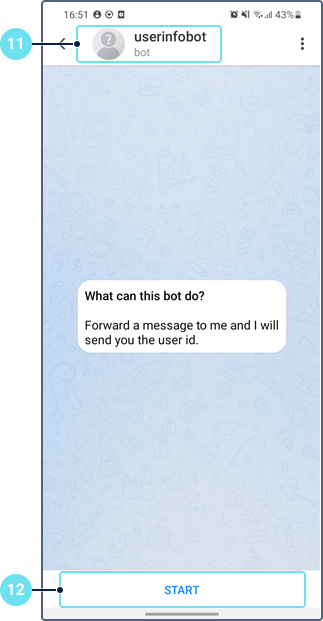

  11. Using the search, find and open the bot named userinfobot.
  12. Tap Start. After that, the user ID is sent. To find out the ID of another user, send any message to this bot on behalf of the required user.
  13. Specify the received ID in the Channel ID field.

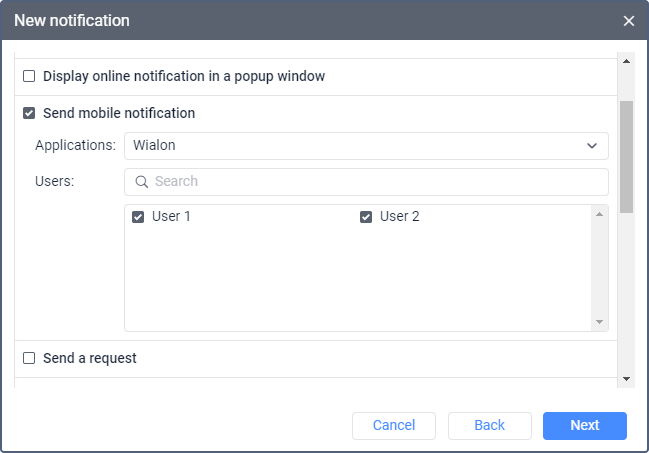

Send mobile notification
This action allows you to configure sending mobile notifications. The action is available if the Mobile notifications service is enabled in the properties of the user’s account.
To work with this action, you should have the following access rights:
Access right type Access rights Description
Unit access rights View object and its basic properties The recipient users should have this access right to all the selected units.
Unit access rights Use unit in jobs, notifications, routes, retranslators The user who configures the notification and the user-creator of the resource to which the notification belongs should have this access right to all the selected units.
User access rights View detailed object properties The user who configures the notification should have these access rights to the recipient users and to the user-creator of the resource in which the notification is stored.
The user-creator of the resource in which the notification is stored should have these access rights to the recipient users.
User access rights Act on behalf of this user The user who configures the notification should have these access rights to the recipient users and to the user-creator of the resource in which the notification is stored.
To configure sending mobile notifications, follow these steps:
  1. Make sure that the users who should receive notifications are authorized in the mobile application and have the option allowing them to receive notifications enabled. In the case of  Wialon for Android and iOS, the Push notifications option should be enabled in the settings.
  2. Select the mobile application to which the notification should be sent.
  3. Select the users who should receive the notification. To find them, use the dynamic filter above the list. To select all the users at once, select one of them while holding down the Ctrl key.

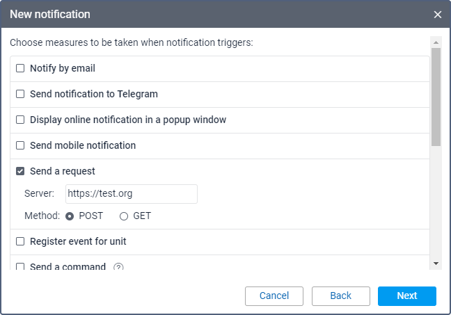

Send a request
This action allows you to send messages about triggered notifications to third-party servers. To configure this, follow the steps below.
  1. In the Server field, specify the URL, that is, the static part of the request.
  2. Select one of the two methods of a HTTP request: POST or GET.
  3. Click Next.
  4. In the notification text field, specify the dynamic part of the request using tags. For example: param1=value1&param2=value2&param3=%UNIT%&param4=%SPEED%
When sending a GET request, its dynamic part is automatically added to the server address specified in step 1. When sending a POST request, the dynamic part is passed in the body of the request.

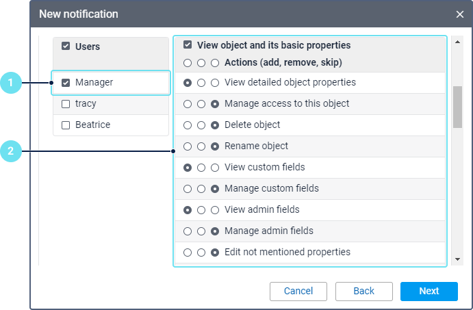

Change access to units
This action allows you to automatically change the user’s access rights to units. To do this, you should have the Manage access to this object access right to the user.
To configure this action, follow these steps:
  1. Select the users whose access rights you want to change.
  2. Next to the required access right, select one of the following actions:
  • Add. Allows you to grant the users this access right.
  • Remove. Allows you to remove from the users this access right.
  • Skip. Allows you not to change this access right.

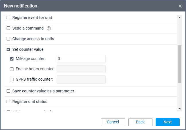

Set counter value
This action allows you to change the values of the mileage, engine hours, and/or GPRS traffic counters. To do this, you should have the Edit counters access right to the unit.
To configure this action, select the required counters and specify the values that these counters should have when the notification is triggered.

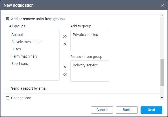

Add or remove units from groups
This action allows you to add or remove the selected unit from certain groups. To add the unit to the group when the notification is triggered, click on the required group in the All groups list and, using the icon , move the group to the Add to group list; to remove from the group, to the Remove from group list. To move the selected groups to the common list, use the icon .

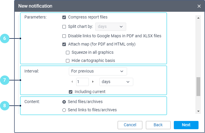

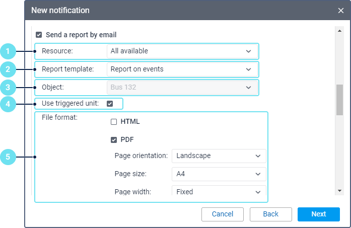

Send a report by email
This action allows you to send a report to one or several specified email addresses. To do this, you should have the Request messages and reports access right.
  1. Select the resource to which belongs the report template you want to send. To see templates from all the available resources, select the All available option.
  2. Select the report template.
  3. Select the object on which you want to execute the report.
  4. If necessary, enable the Triggered unit option. It is only available for reports on unit or unit group. If the option is enabled, the report is executed only on the unit that triggered the notification, regardless of the object selected in the previous list.
  5. Select one or several file formats: HTML, PDF, Excel, XML, CSV. When selecting the PDF format, you can specify the page orientation, size, and width. When selecting the CSV format, you can specify the coding and delimiter as well as enable or disable the displaying of headings.
  6. If necessary, enable additional options (see more).
  7. Specify the time interval for which report should be executed.
  8. Select one of the two options defining the report content:
  • Send files/archives. Allows you to send files or archives directly.
  • Send links to files/archives. Allows you to send links to the FTP server where the files or archives of the report are stored.
    If the file size exceeds 30 MB, the Send links to files/archives option is used automatically.
  1. Specify and select the email addresses of the recipients of the report. A new field is added automatically after each input.
The information about the geodata in the notification report is shown in accordance with the settings of the user-creator of the resource in which this notification is created.
If the user-creator of the notification no longer has access rights to the object or this object has been deleted, the notification stops working.

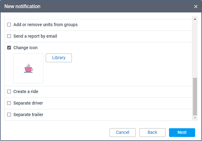

Change icon
This action allows you to select the icon that should be the unit icon when the notification is triggered. To open the list of available icons, click on the Library icon.

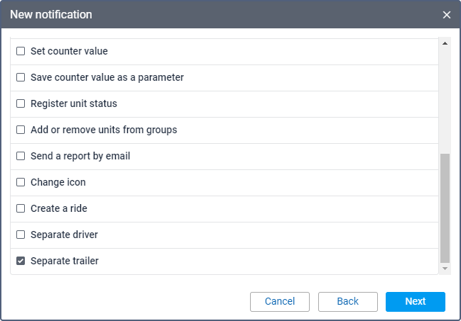

Separate driver
For this notification action, you should have the Create, edit, delete drivers access right to the resource to which the driver belongs.
This action allows you to automatically separate the driver from the unit. If several drivers are assigned to a unit, all of them are separated after the notification is triggered. The drivers and the notification should belong to the same resource.
See more information about the automatic separation of drivers.
Separate trailer
For this notification action, you should have the Create, edit, delete trailers access right to the resource to which the trailer belongs.
