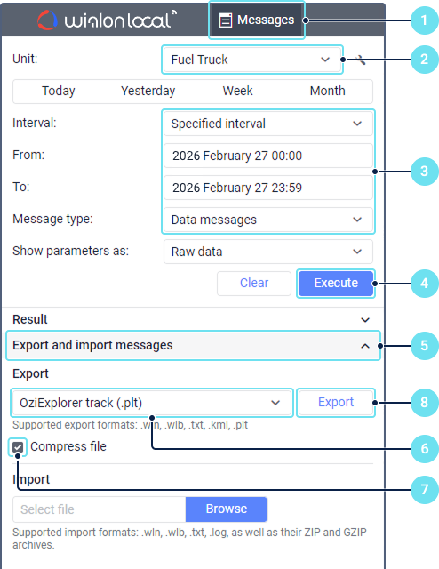

To export messages to the file, follow the steps below.
  1. Open the Messages tab.
  2. Select the unit in the drop-down list.
  3. Specify the request interval and select the type of messages.
  4. Click Execute. You can request messages in other ways.
  5. Go to the Export and import messages in the lower-left part of the window.
  6. Select the format of the resulting file.
  7. Enable the Compress file option, if you want to create an archive with exported messages.
  8. Click Export.
Depending on your browser settings, the created file will be opened immediately or you can specify a path for saving the file.
