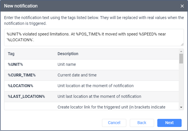

Notification text
You can specify text for the following notification actions:
  • notify by email;
  • notify by SMS;
  • send notification to Telegram;
  • display online notification in a pop-up window;
  • send mobile notification;
  • send a request;
  • register event for unit.
The notification text can be in any language and contain any characters.
If the Notify by SMS action is selected, it is not advisable to specify a long text. If the text length exceeds the maximum allowed SMS message length, the text is sent in multiple messages.
If you select the Send a request action, you should enter the request parameters in the notification text. In addition to the parameters, you can enter text using URL encoding. If you use this action together with others (for example, notify by email or SMS), the same text is generated for all the notifications.
You can add tags to the text. These are keywords which are converted to the values ​​to which they correspond when the notification is triggered. For example, the text “%UNIT% violated speed limits and at %POS_TIME% it was moving at a speed of %SPEED% near ‘%LOCATION%’” is converted to "Rover119 violated speed limits and at 2022-05-01 12:01: 37 was moving at a speed of 156 km/h near the ‘KU 8, Thurnau, DE’. To add a tag to the text, click on it or enter it manually.
A tag must be marked with a percent sign on both sides. Otherwise, it is considered as plain text and is not replaced by real values.
The units of measurement (kilometers or miles) used to decipher the tags depend on the settings of the resource to which the notification belongs. The date and time format is taken from the settings of the resource creator.
A set of tags which can be used in the text depends on the notification type. Below is a list of tags available for most notification types.
