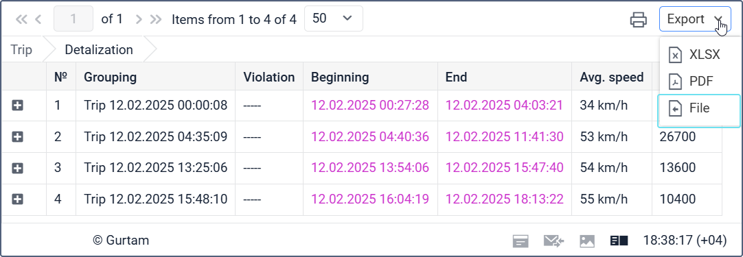

There are two methods of exporting a report: instant export and export with settings. Instant export is available only for XLSX and PDF formats.
Instant export
You can save a report in XLSX or PDF format following these steps:
  1. Click on Export in the toolbar of the generated report.
  2. Select the XLSX or PDF format in the dropdown list.
  3. Open the file or save it to the disk depending on your browser settings.

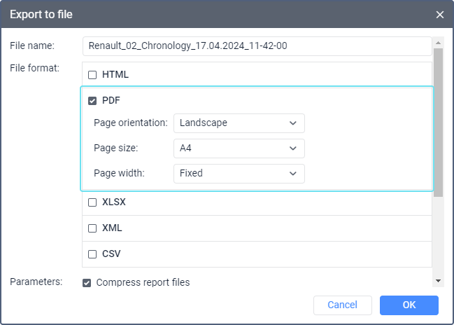

Export with settings
You can get the same report in several files of the available formats. To do this, follow these steps:
  2. Select the File option.
  3. If necessary, change the file name generated automatically.
  4. Select the necessary formats. For PDF and CSV, additional settings are available in the menu.
  5. Specify the required parameters.
  6. Click OK.
  7. Depending on your browser settings, open the file or save it to the disk.

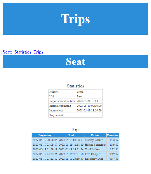

HTML
If you select the HTML format, the report is saved as a web page. You can open it in any internet browser installed on the computer.

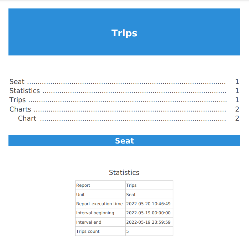

PDF
PDF reports are well-suited for printing.
When exporting the report to a PDF file, the following additional options are available:
OptionDescription
Page orientationSelect the page orientation: portrait or landscape.
Page sizeSelect the page size: A4 or A3.
Page width
This option is useful for reports with many columns. You can select one of the following options:
  • Fixed. The page width depends on the selected page orientation and size. If the width of a table doesn't fit, the report is exported without this table (only its title is shown).
  • Auto, compact. The width of a table cell is equal to the width of the widest word in a column.
  • Auto, no wrap. The width of a table cell is equal to the width of the longest row (without line wrapping).
When you select Auto, compact or Auto, no wrap, the selected page size and orientation influences the page height, but not the page width.

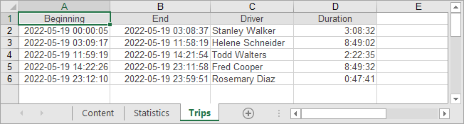

Еxcel
Reports exported to an Excel (XLSX) file are displayed on several tabs. You can edit the report data using the tools of this programme.

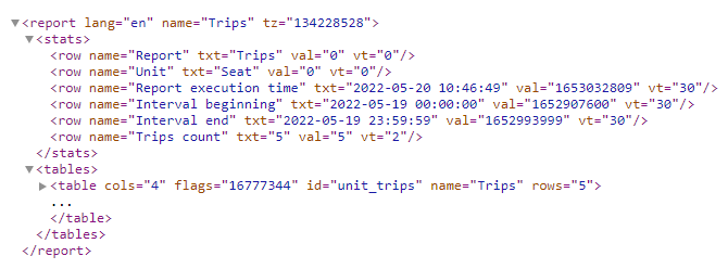

XML
If you select the XML format, the report is saved as a text file with structured data. A file of this format can be used for third-party systems.
