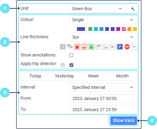

To view a track, open the Tracks tab and do the following:
  1. Select a unit from the drop-down list. It shows the units from the work list on the Monitoring tab if you have the specified access right to them. If the work list is empty (when filtering by data recency is applied or when units have been deleted from the list manually), the drop-down list contains the units to which you have the required access right.
  2. Specify the track parameters if necessary.
  3. Specify the time interval for which you want to view the track. The ways of selecting a time interval are the same as in reports.
  4. Click Show track.
As a result, you can see the line of the unit movement mapped taking into account the specified parameters, if there are messages with coordinates for the selected interval. When the track is shown, you can’t show its parameters or  the selected unit. In case of an error, delete the wrong track and create a new one.

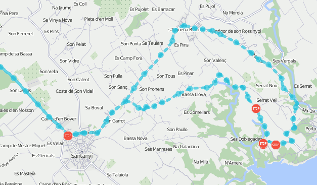

Particularities of displaying tracks
If the unit was motionless within the selected interval, the track is not mapped, but is added to the list of tracks. For such a track, a zero mileage value is shown.
A track or its part can be shown on the map as a dotted line if there is not enough data. For example, if the Maximum interval between messages parameter (the Advanced tab of the unit properties) has been exceeded, or the number of satellites is less than four (if the message validity filtering is disabled).
The limit on the number of satellites is not applied to Wi-Fi and LBS data messages, therefore, the tracks based on such messages are always shown as a solid line.
If a unit has a Private mode sensor with the Do not show unit location option enabled, then a straight dotted line which connects business trips is shown instead of a private trip.
