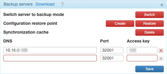

Option Description
Switch server to back up mode The option which allows switching the backup server to the primary mode. See more.

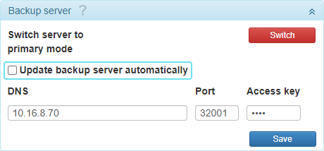

Update backup server automatically The option is available if the administration system is running in the backup server mode (see the image below) and the backup server has been installed in the /home/wialon/wl_storage_backup directory in accordance with method 1.
If the option is enabled, then when installing an update that contains a backup module, not only the /home/wialon/wlocal/modules/backup folder is updated, but also the software part of the backup server installed in the /home/wialon/wl_storage_backup directory.
The following components are updated in the /home/wialon/wl_storage_backup directory:
  • bin, dep, lib, plugins, and scripts folders;
  • adf_script, adf_service.txt and environment.txt files.
The storage (backup server database), custom (backup server settings), tmp, and logs folders are not updated.
If the option is enabled, then when installing an update that contains a backup module, the backup server is automatically restarted.
Configuration restore point The option which allows creating a copy of the configuration data and restoring such data.
Synchronization cache An option for viewing and manually deleting synchronization cache files available on the server.
To delete files, click the Delete button, select files from the list, and confirm their deletion. By default, all unused files are selected in the list. Active files currently utilized by the system are marked as In use.
DNS, Port, Access key In these fields, you should specify the DNS, port, and access key for each backup server, respectively. These parameters are verified against those specified in the config.txt file of the backup server.
In the image below, you can see the Backup server section of the administration system running in the backup server mode.
