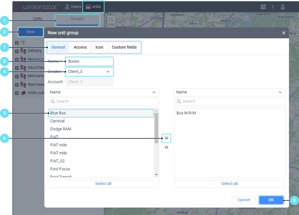

To create a unit group, follow these steps:
  1. Switch to the Groups mode on the Units tab.
  2. Click on the New button.
  3. Specify the group name.
  4. If necessary, select the creator of the group in the drop-down list.
  5. In the left list, select units you want to add to the group. To quickly search for them, use the dynamic filter above the list.
  6. Move the selected units from the left list to the right one using the icon  or by double-clicking them.
  7. If necessary, configure the Access, Icon, and Custom fields tabs.
  8. Click OK.

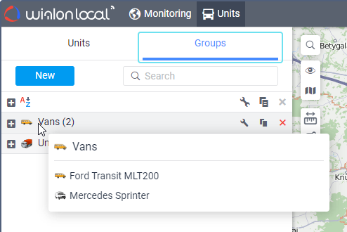

The created group is automatically added to the list of all unit groups and to the work list on the Monitoring tab (the group view) in the account to which it belongs. To search for groups, you can use the dynamic filter.
To the right of the name of each group, you can see the number of units added to it. To open their list, click on the icon  to the left of the required group or point to its line.
Units which are not included in any of the created groups are listed in the Units outside groups group.

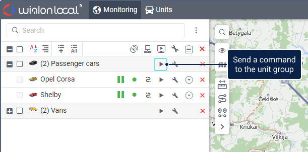

Depending on the options enabled on the Monitoring tab, you can switch to the group view and see the parameters of all the units added to the group (for example, data recency, connection status, etc.) and send a command to all of them at once.
