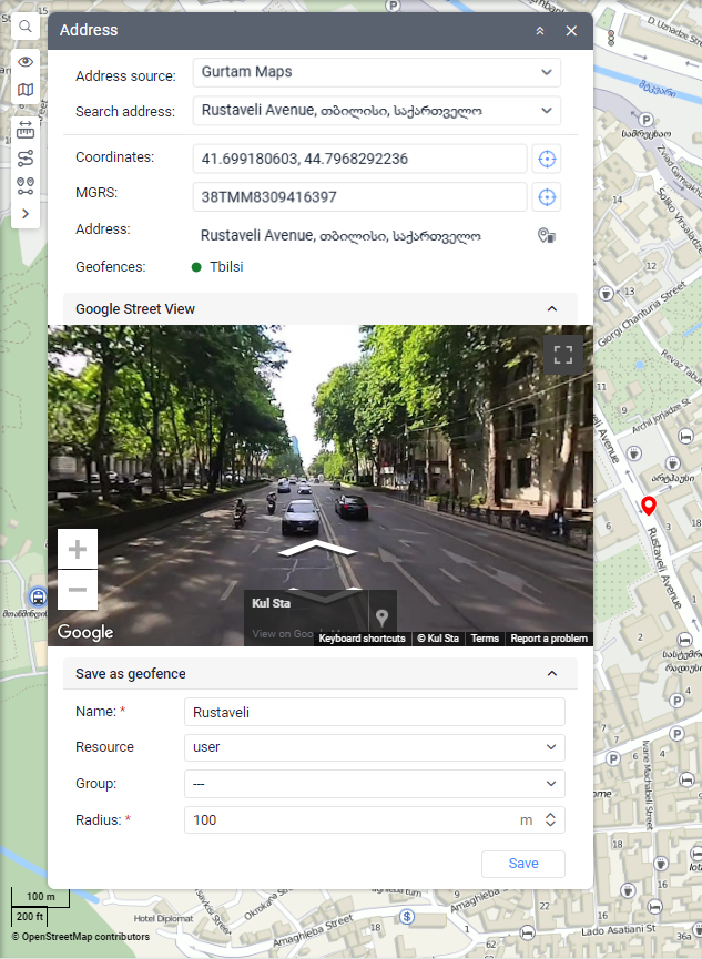

The found place is marked on the map with a red marker: . The tool window displays additional information (see below).

The specified location is marked with a red marker, and additional information is displayed in the tool window (see below).

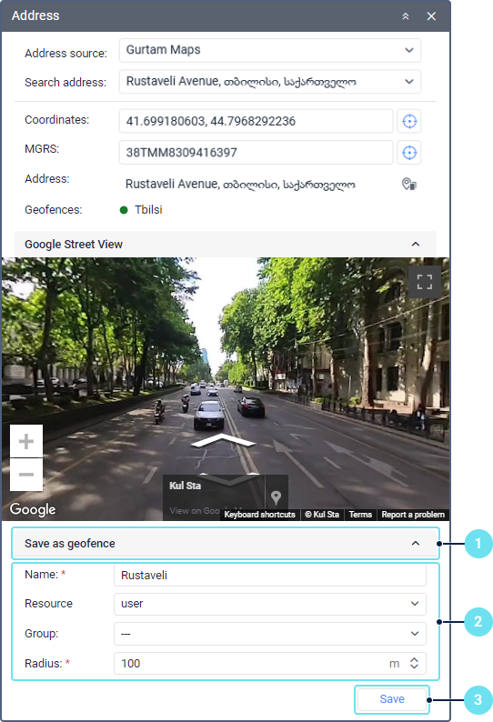

Saving a point as a geofence
You can save the marked place as a circle geofence. To do this, follow these steps:
  1. Expand the Save as geofence section in the tool window.
  2. Specify the geofence properties. The required fields are marked with an asterisk.
    Property
    Description
    Name*Enter the geofence name. The geofence name should contain at least one character. See input rules. The name is filled automatically if the address has been determined by any method above.
    Resource
    The resource in which the geofence should be stored. This drop-down list is shown if more than one resource is available to the user. By default, the geofence is created in the resource of the user account.
    After creating the geofence, you can’t edit this property.
    Group
    The group to which the geofence should belong.
    Radius*
    The circle radius. Depending on the resource system of measurement, the radius is specified in metric (meters), U.S. (feet), or imperial (feet) units. The default value is 100 m. The value must be a number between 1 and 999999999.
  3. Click Save.
After that, the geofence is added to the work list on the Geofences tab. If necessary, you can edit its properties.
