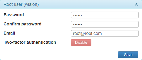

Root user
The root user is wialon. With this username and initially the same password, you can log in to the main tracking interface (Wialon Local Web), CMS Manager, and other Wialon Local services (sites).
To prevent unauthorized access to the features available to the top user, it is recommended to change the password immediately after installing Wialon Local.
On the Wialon page, you can enter the email address and password for the root user. Email is required when you want to reset the password, the password is necessary when you want to log in. If required, here you can also disable two-factor authentication for the root user.
Note that only the root user can create and manage billing plans, apps, and perform conversion.
