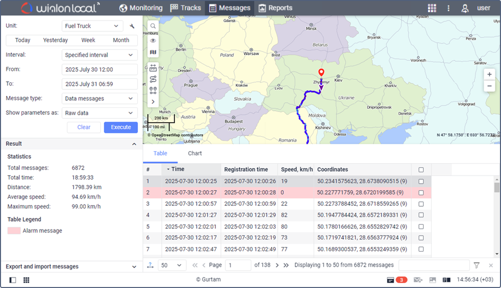

To open the Messages tab, select a corresponding name in the top panel or click on the necessary item in the main menu customizer. The workspace of the panel can be divided into four blocks:
  • in the left top corner, you can set the parameters of your request;
  • in the bottom left part, there is the statistics for current request or a panel to export/import messages;
  • in the top right section, there is the map;
  • at the lower right section, there are messages themselves.
The sectors can be resized (the left ones — in width, the right ones — both in width and height). To do this, click on the border between them with the left mouse button and while holding it, move the border to the right/left or up/down. At the same time, if less than 10% of the map is left while expanding the lower sector, the map automatically collapses. To return it, press on the line under the top panel.
