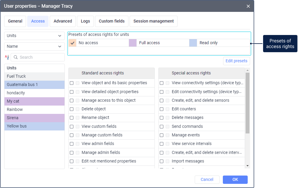

The list of presets is in the upper part of the Access tab. Here you can create, edit and delete the presets. You can work with presets both in the properties of the user to whom the rights are granted, and in the properties of the object to which the user should get access.
Creating presets
If you work with presets from the user properties, then each type of object (unit, route, resource, etc.) has its own lists of presets. Therefore, when you select different types of objects in the drop-down list on the left, you can see different lists of presets.

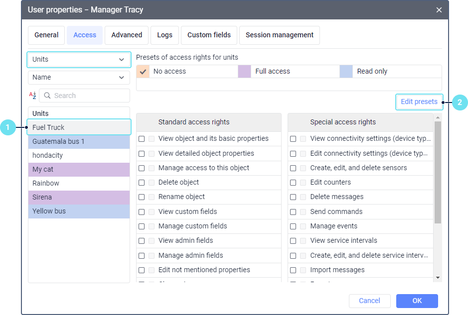

To create a new preset, follow the steps below.
  1. Select the object type and the object to which the user should get access rights from the new preset.
  2. Click Edit presets.

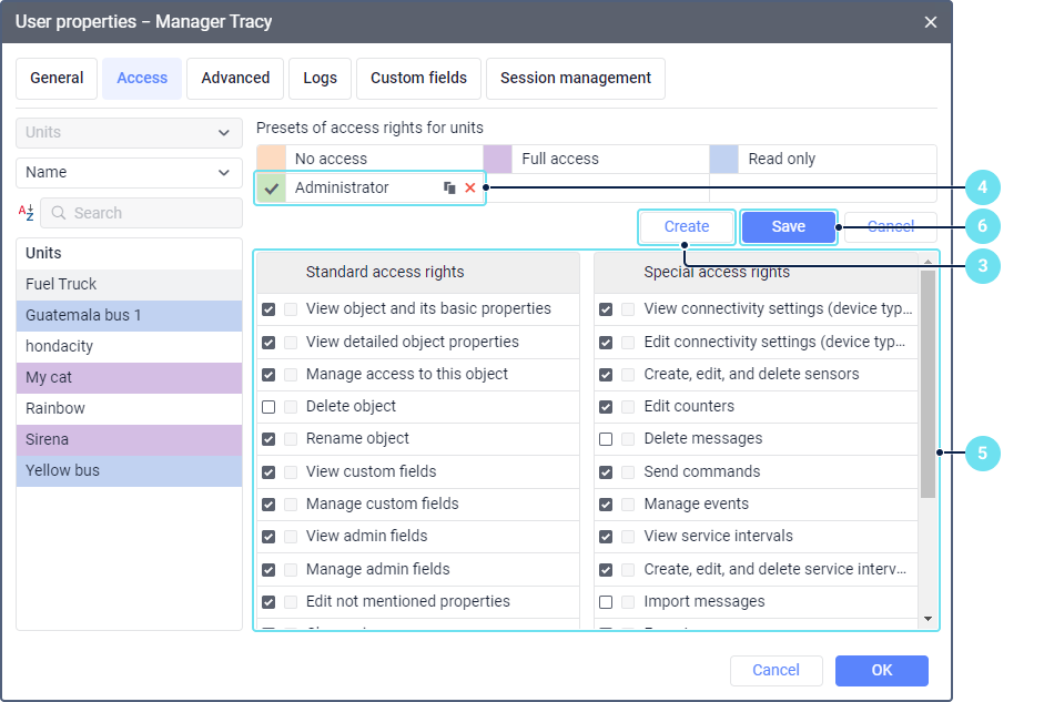

  3. Click Create.
  4. Specify the name of the new preset in the automatically added row. To do this, double-click on this row and enter a name.
  5. In the lists of standard and special access rights, select the ones that should be included in the preset.
  6. Save the preset.

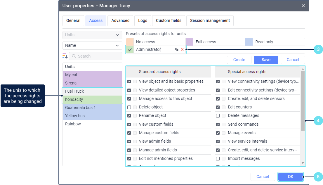

If you want to create a preset on the basis of an existing one, follow the steps below.
  1. Follow steps 1 and 2 from the previous guide.
  2. Point to the preset on the basis of which you want to create a new one and click on the icon .
  3. Change the name of the preset copy added at the end of the list. To do this, double-click on the preset row and enter a new name.
  4. Change the set of standard and special access rights for the new preset.
There can’t be presets with the same set of access rights in the system. Therefore, if you don’t make changes to a preset copy, it won’t be saved.
  1. Save the preset.
In both cases, a preset with the selected access rights is created and automatically applied to the selected object.
