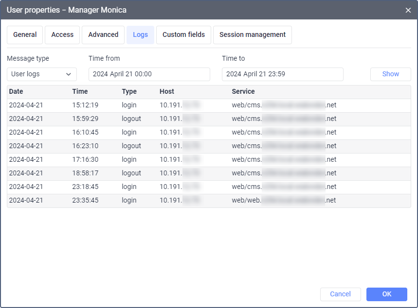

To work with the Logs tab, you should have the Request reports and messages access right.
This tab contains a table which shows how many times the user has logged in or out of the system. To request data for a specific period, select it in the calendar and click Show.
Each line shows the following information about logging in or out of the system:
  • date;
  • time;
  • action type;
  • host (IP address of the device) from which the user logged in/out;
  • service to which the user logged in/out.
If the user logged in using the web interface, the web/ prefix is added to the service name.
