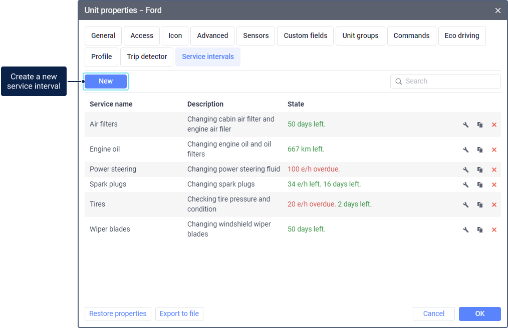

On this tab, you can create, edit, and delete service intervals of the vehicle. Before getting started, see the basic concepts.
ConceptDefinition
ServiceThe type of work related to vehicle maintenance.
IntervalThe frequency of carrying out services.
The list of intervals shows the name of each service, its description (if any), and execution state. In the State column, you can see how many kilometers, engine hours, or days are left before the start of the service. If the service is overdue, the information about its state is highlighted in red.

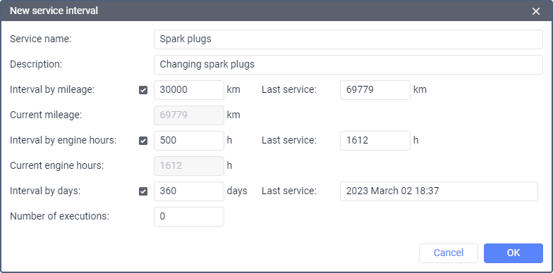

Creating intervals
Before starting to create service intervals, check the counter settings on the General tab and enable the Auto option.
To create an interval, click New. Specify the service name and, if necessary, add a description.
Three options of intervals are available:
OptionDescription
Interval by mileageEnable this option and specify the number of kilometers after which the service should be carried out again. In the Last service field, specify the mileage value at which the service was carried out last time.
Interval by engine hoursEnable this option and specify the number of engine hours after which the service should be carried out again. In the Last service field, specify the value of engine hours at which the service was carried out last time.
Interval by daysEnable this option and specify the number of days after which the service should be carried out again. In the Last service field, specify the date on which the service was carried out last time.
If you specify all the intervals at the same time, the term of each interval is calculated separately. For example, the completion term of a service may be overdue by mileage or engine hours but not by days.
In the Number of executions field, you can specify how many times the service has already been carried out.
To save the interval, click OK.
Actions with intervals
To perform actions with service intervals, use the icons at the end of each line.
IconDescription
Open the interval properties.
Create a new interval with the same properties. A click on the icon opens the window for creating a new interval where you can make changes and save them.
Delete the interval.
To find a specific interval among the created ones, use the dynamic search above the list. It allows searching for intervals by name and description.

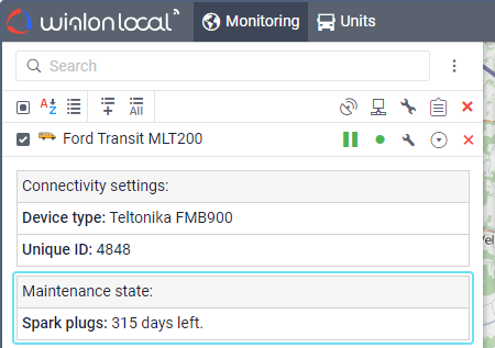

The “Monitoring” tab
All the created service intervals and their execution state can be shown in the unit tooltip and in the extended unit information on the Monitoring tab.
To see them, enable the Maintenance state option in the user settings.
