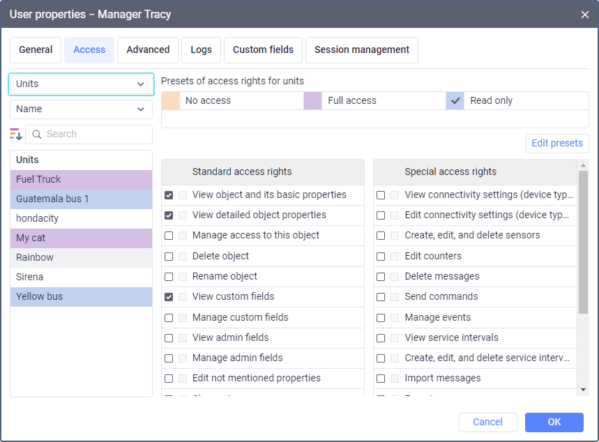

You can change access rights to a unit in two ways: in the properties of this unit or in the user properties. In the user properties, you should select Units in the filter, mark the required unit in the list and select the rights the user should have to this unit. Read more about granting access rights here.

Standard access rights
Below are the standard access rights the users may have to units.
Access right Description
