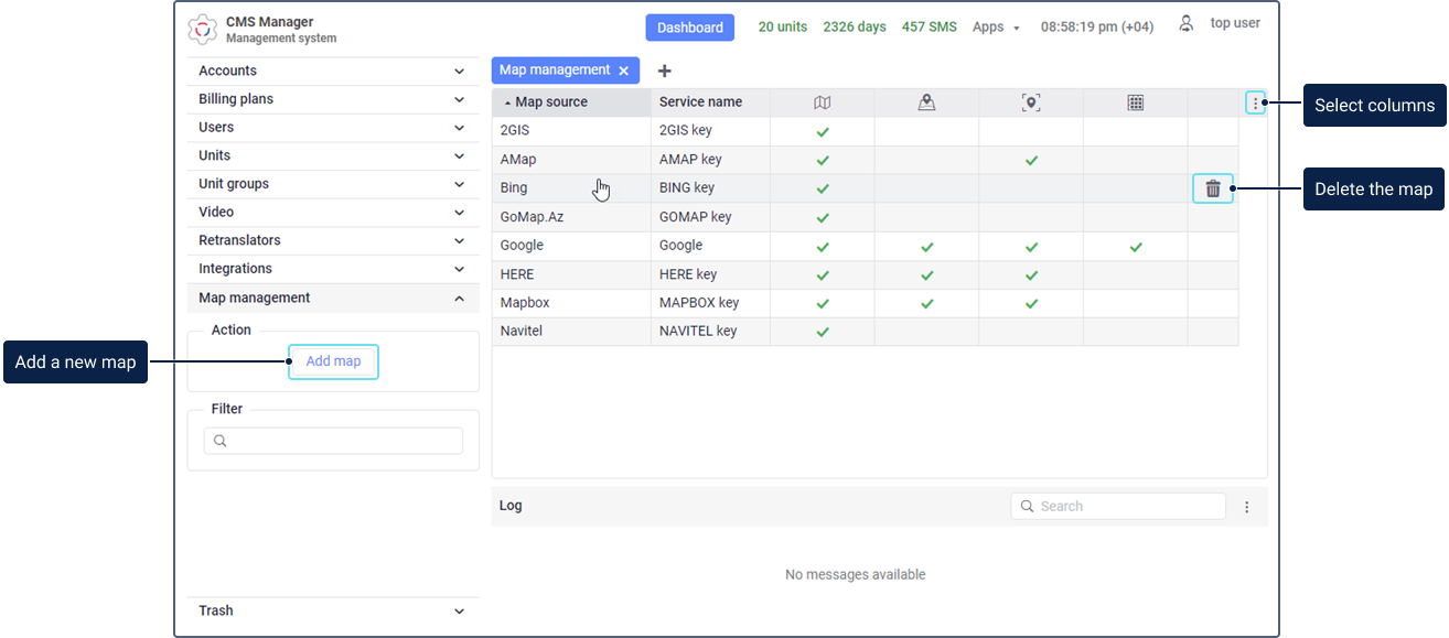

Map management
The Map management section is available only in the CMS Manager and for top accounts. In this section, you can add, edit, and delete maps. A standard table contains all the added maps that can be used as basemap, routing source, geodata source, and distance matrix. The available services of the map are marked with the icon .
When adding a map, you should specify the name of the service with which you can control access to the map and its services. Thus, the top account user can enable or disable this service in the properties of the required billing plans or subordinate accounts.
To change the properties of an added map, click on its row in the table. To delete a map, move the cursor over its row, click on the icon and confirm the action.
Other map settings are described in detail below.

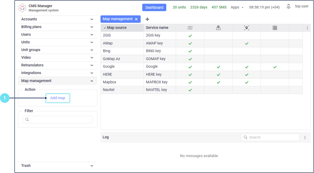

Below you can see the steps required to add a map (using the Google map source as an example).
  1. On the Map management section, click Add map.

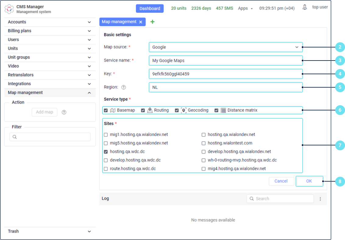

  2. Select the map source. In our example, this is Google.
  3. Specify the name of the service with which you can provide access to the map and selected services.
  4. Specify the map key.
  5. In order for the basemap to be displayed correctly and for the addresses to be determined, specify the code of the region in which the map should be used. For example, NL is the Netherlands (see all codes).
  6. Select one or several service types.
  7. Select the sites on which you can work with the map.
  8. Click OK. After that, the added map is shown in the table.

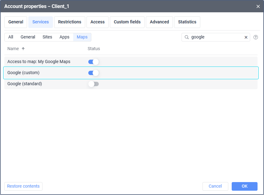

  9. Go to the properties of the billing plan or user account and find the service corresponding to the added map key (Access to map: …).
  10. Activate it using the toggle button.
  11. For Google maps, additionally enable Google (custom). For other maps, enable the services with the name of a map source and the custom mark in brackets, for example, Bing (custom).

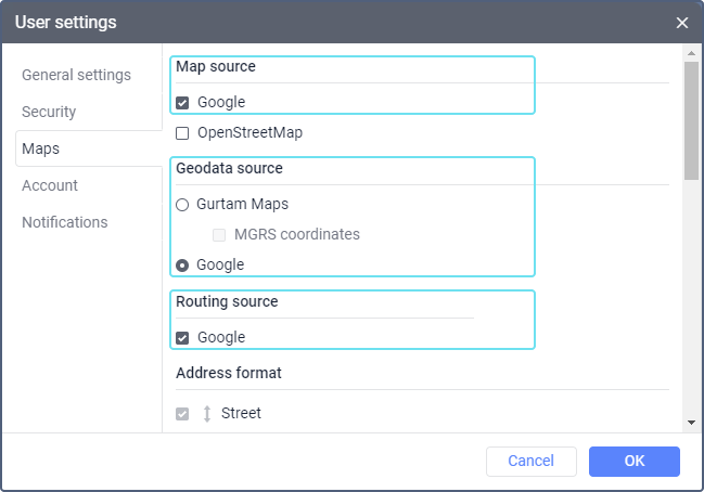

  12. Log in as the user who needs the access to the map.
  13. In the monitoring system user settings, select the added map. Depending on the types of services selected in step 6, it may be available under Map Source, Geodata Source, Routing Source.

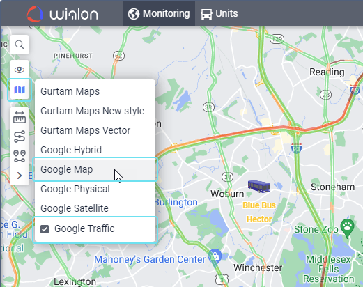

  14. In the upper left corner of the map in the monitoring system, click on the button .
  15. Activate the layer with the necessary map.
