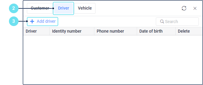

To register a driver, follow these steps:

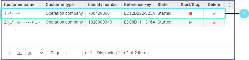

  1. In the table of customers, click on the row of the customer for whom you want to register a driver.
  2. Go to the Driver tab.
  3. Click Add driver.
  4. Fill in the fields below.

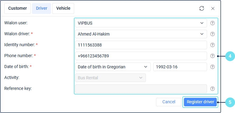

    All the fields are required. Except for the Phone number field, you can’t edit them after the driver is registered.
    Field Description
    Wialon user Select your customer’s Wialon account.
    Wialon driver Select the required driver from the list of drivers created in your customer’s Wialon account. If the list is empty, no drivers have been created in the customer’s account. You can’t select a driver who has already been registered.
    Identity number Specify the driver’s ID indicated on the driver’s licence. It consists of 10 digits.
    Phone number Enter the mobile phone number of the driver. It should contain at least 10 digits. The plus sign is added automatically before the number.
    Date of birth Select the type of calendar (Gregorian or Hijri) and specify the driver’s date of birth.
    Activity The activity type specified when registering the customer. Displayed only if the activity type is not default. This field is not editable.
    Reference key The driver’s reference key. This field is filled in automatically after registering the driver.
  5. Click Register driver.
