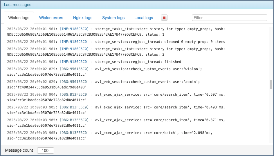

On this page, you can observe different kinds of logs kept in the system. The last hundred messages are available for (in parentheses you can see their physical location on your server):
  • Wialon Local logs (/home/wialon/wlocal/logs/trace.log*)
  • Wialon Local errors (/home/wialon/wlocal/logs/error.log*)
  • Nginx logs (/var/log/nginx/error.log*)
  • System logs (/home/wialon/wlocal/logs)
  • Wialon Local logs of the administration site (/home/wialon/wlocal/logs/lcm/lcm.log\*)
New messages are added to the bottom.
In the upper right corner, there is a dynamic filter that allows sorting the log’s contents according to the introduced value (corresponds to the grep utility).
You can also adjust the number of lines shown in the log. To do this, enter the necessary number in the line Messages cont below (corresponds to the tail utility).
It is possible to stop or start the log using the buttons red square and green triangle pointing right, respectively. If the log is stopped, the two options described above cannot be applied to it.

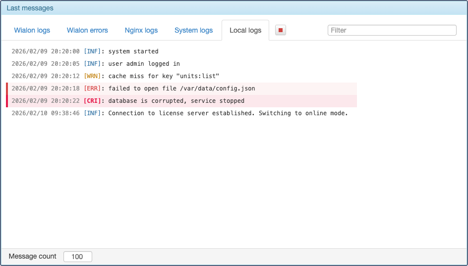

Administration system logs use the following format:
YYYY/MM/DD hh:mm:ss [LEVEL]: message
The date and time are displayed in the server timezone.
Each log entry includes a severity level shown in brackets. The following severity levels are available:
Level Label Description
Critical [CRI] Critical conditions that require maintenance (for example, a site or plugin fails to start).
Error [ERR] Errors that occur during program execution but aren’t critical to program flow.
Warning [WRN] Unusual conditions that are not errors but may require the administrator’s attention.
Info [INF] Informational messages about normal program execution.
Debug [DBG] Detailed information for diagnostics.
Trace [TRC] Detailed information about frequent actions.
Unknown [UNK] Messages with an unrecognized severity level.
Syntax highlighting
Log entries are displayed in a monospace font with color-coded syntax highlighting to help you identify important events quickly:
  • The date and time are highlighted in grey.
  • The severity label is colored according to its level.
  • Lines with Critical or Error severity have a red background and a left border.
