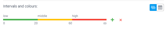

The intervals on the tab are displayed in two modes:
  • in the scale mode
  • in the table mode

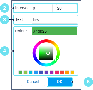

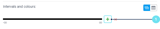

To create intervals in the scale mode, follow these steps:
  1. Click on the scale or the icon .
  2. In the Interval field, specify the interval beginning and end. If the first field is not filled in, its value corresponds to -∞. If the second field is not filled in, its value corresponds to +∞.
  3. In the Text field, enter a caption for the interval.
  4. Select a color using the palette, spectrum, or Hex format.
  5. Click OK.
  6. Follow steps 1–5 for the required number of intervals.
To edit an interval, click on it and specify new values. To delete all intervals, click on the icon .

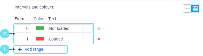

To create intervals in the table mode, follow these steps:
  1. Click on the Add range button.
  2. In the From field, enter the initial value of the first interval, select a color for it, and specify a caption. If the From field is empty, it is considered that -∞ is specified there.
  3. Follow steps 1–2 for the required number of intervals.
To delete an interval, click on the icon  .
