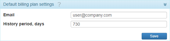

Default billing plan settings
In this section, you can configure the root user’s billing plan.
The section contains the following options:
Option Description
Email The root user’s email (wialon). It is used for sending system messages.
History period, days The data storage period of the root user’s billing plan (that is, of the whole server). The messages deleted at the expiration of the indicated period cannot be restored. If the specified value is 0, the history period is unlimited.
When you reduce the history period value (or change it from 0, which means unlimited, to any other value), all messages older than the new period are deleted in all accounts. Deleted messages can’t be restored.
