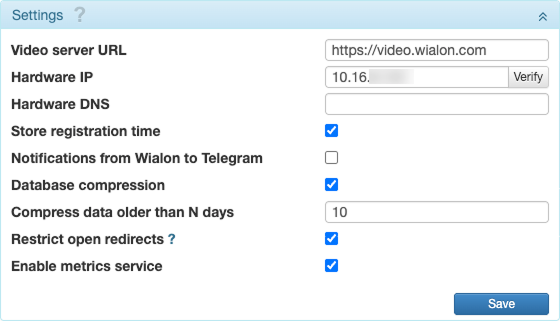

Settings
This section contains settings associated with receiving and saving data from the hardware.
The table below shows the parameters and options available in the section.
Option Description
Video server URL The address of the service for processing and storing video files from devices.
Hardware IP The IP-address of the server to which the data from the units should be sent. It is displayed in the properties of all units in the Server address field.
Hardware DNS The domain name of the server to which the data from the units should be sent. It is displayed in the properties of all units in the Server address field.
Store registration time The option that allows storing the time of the message registration in addition to the time of the message itself. To see this data in the monitoring system, add the Registration time column to the table after you request messages.
Notifications from Wialon to Telegram The option that allows enabling the sending of notifications from Wialon to Telegram. If you activate it, the Send notification to Telegram option becomes available as a notification action when you create and edit notifications in the monitoring system.
In order for such notifications to work, the server with Wialon Local installed should have access to api.telegram.org.
Database compression If this option is activated, all the messages older than the number of days indicated below are compressed and transferred to a separate directory. However, you can still access the messages when executing reports or requesting messages. This allows you to save space and store the most recent messages and the historical ones on storage devices which are different in speed and size (SSD and HDD).
Compress data older than N days The number of days after which messages are compressed. Allowed values are from 10 to 90. If no value is indicated,10 is used by default.
Restrict open redirects The option that restricts open redirects from all sites. Open redirects can be exploited to redirect users to malicious websites. If this option is enabled, only redirects to the URIs specified in the Allowed redirect URIs field in the site settings are permitted. To specify the list of allowed redirect URIs, access the site settings. To apply the changes, restart the site.
Enable metrics service Enables the collection of system metrics in Prometheus format. When enabled, the metrics service starts and exposes an endpoint for external monitoring tools such as Prometheus and Grafana. After changing this setting, click Save and restart the service for the changes to take effect. For details on setting up external monitoring, see Monitoring system metrics with Grafana.
