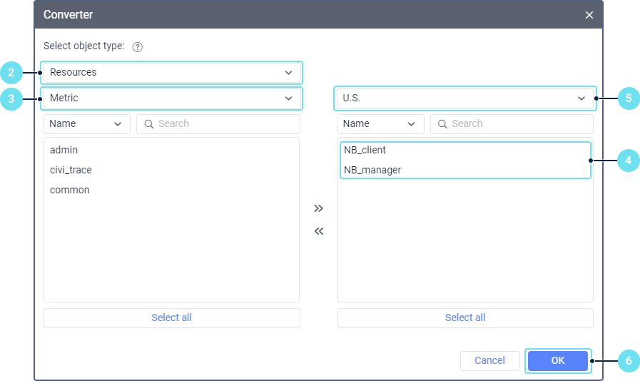

To change the measurement system for a macro-object, follow the steps below.

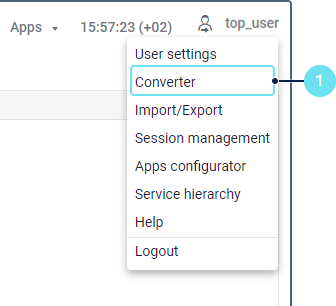

  1. Select Converter in the user menu.
  2. In the drop-down list, select the object type for which you want to carry out the conversion: units, resources, users, or routes. Read more about the conversion particularities of these objects below.
  3. Select the original measurement system which you want to change. After you select it, the objects using this system are listed below.
  4. Move the objects for which you want to change the measurement system from the left list to the right. For moving the objects, use the icons  and  or a double click on the row. To select several objects, hold down the Ctrl key and click on the required rows. To select all the objects at once, click Select all.
  5. Select the measurement system you want to set for the selected objects.
  6. Click ОК to complete the conversion.
As a result, the log shows a record of the completed conversion and the measurement system of the selected objects changes.
