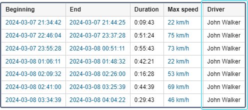

You can add a column with the name of the driver to the tables of most reports (Trips, Engine hours, Fuel fillings and battery charges, Fuel drains, Speedings, etc.). The name is displayed if the driver was assigned to the unit during the selected report interval.
You can also apply filtering by driver. This allows you to select what intervals should be included in the report: for example, include only those intervals of trips, parkings, fuel fillings, etc., during which a specific driver (or no driver at all) was assigned to the unit.
