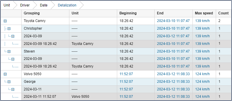

In addition, on the Bind tab of the report template, you can select the units to which the report should be applied. If no units are selected in this section, the report will be applied to all available units.
The Assignments table is designed in such a way that the first column is the list of units to which the driver was assigned. It is recommended to apply the detalization option to this table to get a possibility to expand any unit and see more detailed information about all work shift.
To determine the intervals of the assignment, the messages from the unit are also taken into account. If there are such messages, they are considered to be of more priority than the messages about the assignment (the intervals are counted according to them).

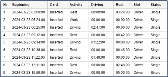

Driver activity
This functionality is considered outdated and not recommended for use.
The Driver activity table shows such information as the type of driver’s action, the crew of a vehicle, the state of the tachograph cards. It can include the columns described below.
Column Description
Beginning The date and time when the activity begins.
Card The state of the digital tachograph (inserted/not inserted).
Activity The type of driver’s activity (rest, work, driving, available, not available).
Source The source of data, which is used to generate information about driver activity. The following column values are available: E — the data about trips is used; T — the tachograph data is used; U — the data about driver separation is used; None — the data source is unknown.
Unit The name of the unit to which the driver is assigned.
Driver The name of the assigned driver (only in the report on the group of drivers).
Driving The time of driving.
Work The hours of active work (time spent by the driver on vehicle repair, fuel filling, etc.).
Availability The hours of passive work (time spent by the second driver in the moving vehicle).
Rest The time for rest of the driver (vehicle is stopped, the driver rests in a specially designated place).
Overall work The total time spent by the driver on such actions as driving, work, reserve.
Slot The slot for digital tachograph card (driver or co-driver).
Status The vehicle crew size (single/crew).
Daily mileage The distance covered by the assigned driver during the day (24 hours).
The last row of the table shows 0:00:00 instead of the duration value for all activity types, because the end time of the driver’s activity is unknown, regardless of the selected data source.

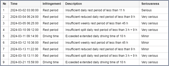

Infringements
This table shows the information on the violations of labor routine by the driver. The violations are determined in accordance with the AETR regulations.
The table can include the columns described below.
Column Description
Time The date and time of the infringement registration.
If the driver has been driving for 6 hours or more, the infringement is registered at the moment when driving, excluding work, has lasted 6 hours (+/- 1 minute) from the start of movement. Such an infringement is considered very serious. If the driver has been driving for 5 to 6 hours, the infringement is registered at the moment when driving has lasted 5 hours, and if they have been driving for 4.5 to 5 hours, the infringement is registered at the moment when driving has lasted 4.5 hours. Such infringements are considered serious and minor, respectively.
Thus, if you run the report for today twice, you may get different data on the last infringement of driving duration. For example, if the driver has managed to drive 4 hours and 40 minutes by the first report execution, and 5 hours by the second, then the infringement registration time and seriousness in the first and second reports will differ. At the same time, regardless of the seriousness degree, the description “Exceeded uninterrupted driving time of 4 h 30 min” is displayed for such infringements.
Infringement The type of driver’s activity the conditions of which have been violated.
Description A short description of the infringement.
Seriousness The extent of the infringement.
Count The number of violations. If the grouping option is activated, this column shows the total number of violations for the selected interval.

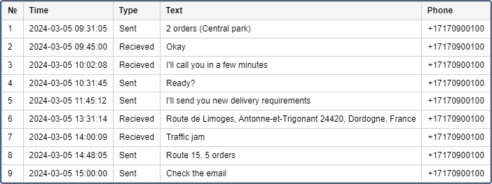

SMS messages
This table shows the correspondence of the dispatcher with the driver via SMS. The dispatcher (operator) can send messages to the driver from the Wialon interface through a special SMS window. The driver sends messages from their mobile phone. This mobile phone number must be indicated in the driver’s properties.
This table is available only for reports on a group of drivers.
The columns that can be included in the table are listed below.
Column Description
Time The date and time when the message arrived.
Type The message type: sent (message sent by the dispatcher) or received (message received from the driver).
Text The text of the message.
Phone The phone number of the driver.
Modem phone The phone number of the modem that sent/received an SMS.
