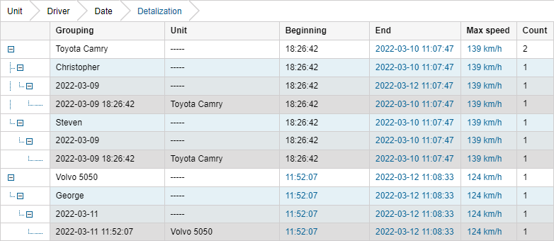

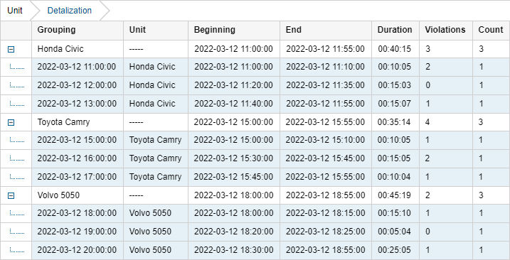

Assignments
The Assignments table shows when and to which unit the driver was assigned, how long his work shifts lasted, how much fuel was spent, the distance travelled, etc.
The table can include the columns described below.
| Column | Description |
| Unit | The name of the unit to which the driver was assigned. |
| Driver | The name of the assigned driver (only in the report on the group of drivers). |
| Beginning | The date and time when the driver was assigned to the unit. |
| Initial location | The initial position, that is, the address at that moment (if available). |
| End | The date and time when the driver was separated from the unit. |
| Final location | The final position, the address at that moment (if available). |
| Duration | The duration of a work shift. |
| Total time | The time from the beginning of the first shift to the end of the last shift. |
| Engine hours | The total amount of engine hours for a working interval of the driver. |
| Engine hours in movement | The number of engine hours for the interval of movement with the assigned driver. The movement is considered those intervals in which the speed value was greater or equal to the one from the Min moving speed field in the trip detector. |
| Engine hours in idle run | The number of engine hours for the interval of idling with the assigned driver. |
| Mileage | The distance travelled within the period. |
| Mileage (adjusted) | The mileage taking into account the coefficient set in the unit properties on the Advanced tab. |
| Urban mileage | The distance travelled in the urban area. |
| Suburban mile age | The distance travelled in the suburban area. It is calculated in regards to speed. The urban/suburban speed line is indicated on the Advanced tab (the Urban speed limit setting). |
| Avg speed | The average speed on a given interval. |
| Max speed | The maximum speed registered within this work shift. |
| Counter | The value of the counter sensor. |
| Status | The status of the unit registered during the interval (if there are several, the first one is displayed). |
| Violations | The number of violations. |
| Count | The number of assignments found on a given interval. |
| Consumed | The amount of fuel consumed in total for all fuel sensors. |
| Consumed by... | The volume of consumed fuel detected by any fuel sensor (such as impulse/absolute/instant fuel consumption sensor, fuel level sensor) or calculated by math or rates. |
| Avg consumption | The average fuel consumption, determined from the available fuel sensors. |
| Avg consumption by... | The average fuel consumption in the trip detected by one of the methods mentioned above. |
| Initial fuel level | The fuel level at the beginning of the work shift. |
| Final fuel level | The fuel level at the end of the work shift. |
| Penalties | The penalties calculated for the adjusted Eco driving criteria. |
| Rank | The penalty points, converted into a grade using a 6-point rating system. |
| Notes | An empty column for your custom comments. |
In addition, in the report template to the right of the list of columns, you can specify the units to which the report is applied. If no units are selected in this section, the report will be applied to all available units.
The report is designed in such a way that the first column is the list of units to which the driver was assigned. It is recommended to apply the detalization option to this table to get a possibility to expand any unit and see more detailed information about all work shift.
To determine the intervals of the assignment, the messages from the unit are also taken into account. If there are such messages, they are considered to be of more priority than the messages about the assignment (the intervals are counted according to them).

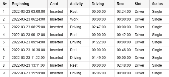

Driver activity
The Driver Activity table shows such information as the type of driver’s action, the crew of a vehicle, the state of the tachograph cards. It can include the columns described below.
| Beginning | The date and time when the activity begins. |
| Card | The state of the digital tachograph (inserted/not inserted). |
| Activity | The type of driver's activity (rest, work, driving, available, not available). |
| Source | The source of data, which is used to generate information about driver activity. The following column values are available: E — the data about trips is used; T — the tachograph data is used; U — the data about driver separation is used; None — the data source is unknown. |
| Unit | The name of the unit to which the driver is assigned. |
| Driving | The time of driving. |
| Work | The hours of active work (time spent by the driver on vehicle repair, fuel filling, etc.). |
| Availability | The hours of passive work (time spent by the second driver in the moving vehicle). |
| Rest | The time for rest of the driver (vehicle is stopped, the driver rests in a specially designated place). |
| Overall work | The total time spent by the driver on such actions as driving, work, reserve. |
| Slot | The slot for digital tachograph card (driver or co-driver). |
| Status | The vehicle crew size (single/crew). |
| Daily mileage | The distance covered by the assigned driver during the day (24 hours). |
While creating this report template, you should select the source to determine driver activity in the Interval filtration item in the settings: DDD files (are sent by the tachograph), Online data (are generated online on the basis of assignments and trips) or Assignments and trips (messages are used as the source). If the Assignments and trips source is selected, the result of the report changes when you change the trip detector settings, delete messages, register or delete assignments, etc.

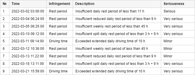

Infringements
This report shows the information on the violations of labor routine by the driver. The violations are determined in accordance with the AETR regulations.
The report can include the columns described below.
| Time | The date and time of violation recording. |
| Infringement | The type of driver's activity the conditions of which have been violated. |
| Description | A short description of the infringement. |
| Seriousness | The extent of the infringement. |
| Count | The number of violations. If the grouping option is activated, this column shows the total number of violations for the selected interval. |

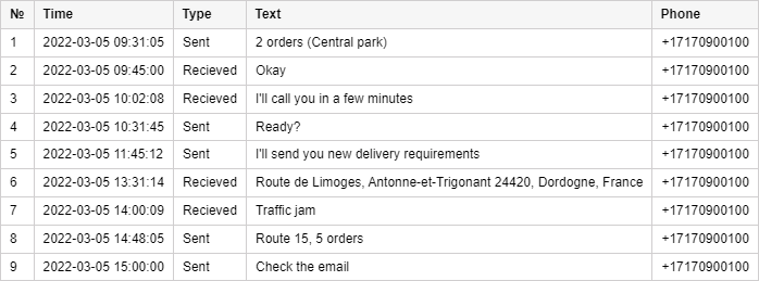

SMS messages
This report shows the correspondence of the dispatcher with the driver via SMS. The dispatcher (operator) can send messages to the driver from the Wialon interface through a special SMS window. The driver sends messages from his mobile phone. This mobile phone number must be indicated in the driver’s properties.
This table is available only for reports on the group of drivers.
The columns that can be included in the table are listed below.
| Time | The date and time when the message arrived. |
| Type | The message type: sent (message sent by the dispatcher) or received (message received from the driver). |
| Text | The text of the message. |
| Phone | The phone number of the driver. |
| Modem phone | The phone number of the modem that sent/received an SMS. |

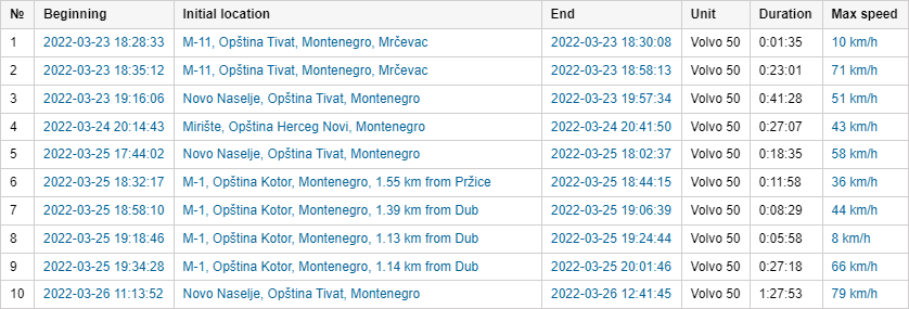

Trips
The Trips table displays the location, duration, speed, and other parameters. It can include the columns described below.
| Beginning | The date and time when the trip began. |
| Initial location | The address where the device was at the beginning of the trip. |
| Initial coordinates | The geographical coordinates of the location of the unit at the beginning of the trip (in decimal degrees). |
| End | The date and time when the trip ended. |
| Final location | The address where the device was at the end of the trip. |
| Final coordinates | The geographical coordinates of the location of the unit at the end of the trip (in decimal degrees). |
| Driver | The name of the driver assigned to the unit (only in the report on the group of drivers). |
| Unit | The name of the unit used in the trip. |
| Trailer | The name of the trailer (if assigned). |
| Duration | The time interval of the trip. |
| Engine hours | The time of the operation of engine hours during the trip. |
| Mileage | The distance travelled during the whole trip. |
| Mileage (adjusted) | The mileage taking a coefficient set in unit properties (the Advanced tab) into account. |
| Suburban mileage | The distance travelled in the suburban area (i.e. at high speed). The urban/suburban speed line is indicated on the Advanced tab (the Urban speed limit setting). |
| Avg speed | The average speed within the trip. |
| Max speed | The maximum speed registered within the interval. |
| Trips count | The number of completed trips. |
| Consumed | The volume of consumed fuel detected by any sort of fuel sensor. If several such sensors are available, their values sum up. |
| Consumed by... | The volume of consumed fuel detected by a fuel sensor (such as impulse/absolute/instant fuel consumption sensor, fuel level sensor) or calculated by math or rates. More information about fuel in reports can be found here. |
| Rates deviation by... | The difference between consumed fuel detected by a sensor and consumption rates. If a number in this cell is negative, it means the detected consumption does not exceed the indicated rates. |
| Avg consumption | The average fuel consumption by any sort of fuel sensor. If several such sensors are available, their values sum up. |
| Avg consumption by... | The average fuel consumption during the trip detected by one of the methods mentioned above. |
| Avg consumption in idle run by... | The average fuel consumption during the idle run. |
| Avg mileage per unit of fuel by... | The average fuel consumption (per one liter/gallon) detected by one of the methods mentioned above. |
| Initial fuel level | The fuel level at the beginning of the trip. |
| Final fuel level | The fuel level at the end of the trip. |
| Max fuel level | The maximum fuel level during the trip. |
| Min fuel level | The minimum fuel level during the trip. |
| Rank | The received penalty points converted into a grade using a 6-point scoring system. |
| Avg value of custom sensor | The average value of a custom sensor during the trip. |
| Min value of custom sensor | The minimum value of a custom sensor during the trip. |
| Max value of custom sensor | The maximum value of a custom sensor during the trip. |
| Initial value of custom sensor | The custom sensor value at the beginning of a trip. |
| Final value of custom sensor | The custom sensor value at the end of a trip. |
If you add a column with a custom sensor value (Avg value of custom sensor, Min value of custom sensor, Max value of custom sensor, Initial value of custom sensor, Final value of custom sensor) to this table, then you should specify the full name of the required sensor in the Custom sensor name filter. Otherwise, you cannot save the report template.
