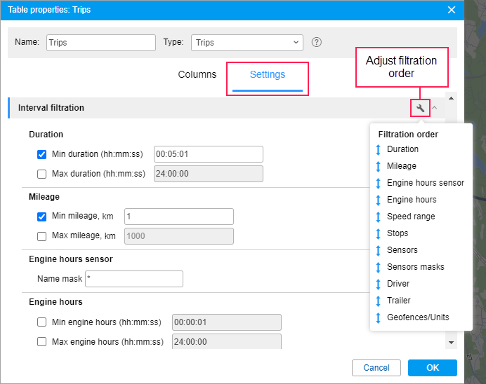

Interval Filtration
When executing most tabular reports in the Wialon system, time intervals corresponding to the table type are retrieved from the unit history. For example, the intervals refer to the unit trips in a report on trips, while in a report on geofences, the intervals refer to the unit being within a geofence. You can apply filtration to these intervals on the basis of certain parameters. For example, the report can show only those trips that lasted longer than the specified time, or only those geofence visits during which the vehicle was parked.
You can see the Interval filtration section on the Settings tab of the table properties. The available filters, that is, the parameters on the basis of which filtration is carried out, depend on the table type.
You can apply several filters simultaneously. To change the order in which the filters are applied, click on the icon  and drag the list items above or below.
All filters except for the mileage filter work only with integer values.
All the possible filters are described in detail below.

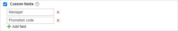

Custom fields
The filter is available in the Orders table and works by custom fields specified in the order properties in the Logistics application. It allows you to specify the names of custom fields which should be shown in the report. If the filter is disabled, the report shows all the custom fields from the orders included in the routes for the selected report interval.

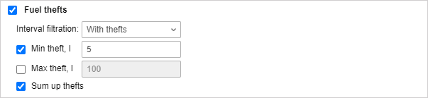

Fuel thefts
The filter allows you to see the intervals within which fuel thefts were detected or intervals with no fuel thefts.
If the With thefts option is selected, then you can specify the minimum and/or maximum amount of fuel drained at one time in the Min theft and Max theft fields in order for the interval to be included in the report. If the Sum up thefts option is activated, then the sum of all thefts within the interval should meet the conditions from the fields.
Example. A report on trips is executed. A value of 5 l is specified in the Min theft field. During the trip, thefts of 2 l, 3 l and 4 l were detected. If the Sum up thefts option is disabled, the trip is not shown in the report. If it is enabled, the trip is shown because the total volume of thefts is 9 liters.

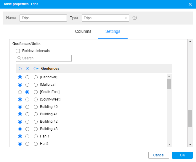

Geofences/Units
The filter allows you to see those intervals within which the unit was inside or outside of the selected geofence or area around the selected unit.
By default, the intervals are shown entirely. To see only those parts of the interval during which the unit was inside or outside of the geofence/unit area, enable the Retrieve intervals option.
When determining the time at which the unit crossed geofences or unit areas, the Maximum interval between messages option from the unit properties is taken into account.
The filter section consists of two lists: the list of geofences and the list of units. Above each list, there is a dynamic search by item name.
For each list item, you can specify one of three statuses:

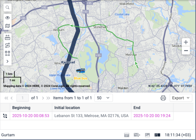

 : Intervals inside this geofence or unit area. The report table includes those intervals where the unit sent at least one message inside the selected geofence (or unit area).
Example. In the image below, the Trips table is filtered by the Inside “Railroad” geofence criterion. It includes a trip during which the vehicle sent messages within this geofence, though only briefly. : Intervals inside this geofence or unit area. The report table includes those intervals where the unit sent at least one message inside the selected geofence (or unit area).

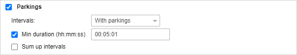

Parkings
The filter allows you to see only those intervals withing which parking periods were detected (With parkings option), or only those intervals within which there were no parking periods (Without parkings option). Parking periods are detected according to the settings in the trip detector. See the detailed description here.
If the With parkings option is selected, you can specify the minimum parking duration in the Min duration field in order for the interval to be included in the report. If the Sum up intervals option is enabled, the duration of all the parking periods within the interval is summed up and compared with the specified minimum duration.
Example. A report on geofence visits is executed. You want the report to show only the visits during which the unit was parked. A value of 10 min. is specified in the Min duration field. The unit had been parked inside the geofence for 5 and for 7 minutes. If the Sum up intervals option is disabled, the geofence visit won’t be included in the report. If the option is enabled, the visit will be shown in the report because the total parking duration was 12 minutes and the minimum duration requirement was met.

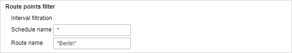

Route points filter
This filter is available in the Check points table. Here in the Schedule name and Route name fields, you can specify masks for schedules and/or routes, respectively. In this case, the report will only show the check points related to the specified schedules and/or routes.

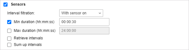

Sensors
This filter allows you to see the intervals within which a sensor of the Digital group was on or off.
The following options are available for the filter:
| Option | Description |
| With sensor on | The report shows the intervals within which the sensor was on. By default, the intervals in the report are displayed entirely. To see only those parts of the interval during which the sensor was on, activate the Retrieve intervals option. In the Sensor masks filter, you can specify the name of a sensor or a mask for several sensors. If several sensors are specified, the report shows the intervals within which all of them were on at the same time. If no sensor is specified, all the unit sensors are taken into account in the report. |
| With sensor off | The report shows the intervals within which the sensor was off. For this option, you can also retrieve intervals and specify a sensor mask (see the description above). |
| Min duration | The minimum time during which the sensor should be on or off in order for the interval to be shown in the report. |
| Max duration | The maximum time within which the sensor should be on or off in order for the interval to be shown in the report. This option is used if you don't want the report to take into account the sensors that are on for a long time. |
| Retrieve intervals | If the option is disabled, the intervals in the report are shown entirely when they match the filter conditions. If the option is enabled, then the report shows only those parts of the interval during which the sensor was on or off. Each such part occupies a separate line. |
| Sum up intervals | This option can only be used if the Min duration and/or Max duration fields are filled in. If it is enabled, then all the periods during which the sensor was on or off within the report interval are summed up and the result is compared with the specified duration value. If the amount matches the condition, the interval is shown in the report. Example. A report on trips with the sensor on is executed. A value of 60 seconds is indicated in the Min duration field. The Sum up intervals option is activated. During the trip, the sensor was on for 20 seconds, for 30 seconds and for 15 seconds, that is, for a total of 65 seconds. This value meets the minimum duration condition, therefore, the trip is shown in the report. |

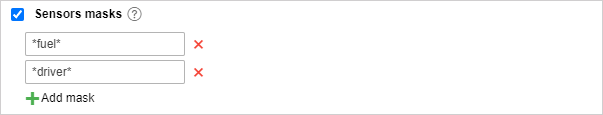

Sensor masks
Here you can specify the masks of the sensors which should be taken into account when executing the report. The specified masks influence:
- Sensors filter**;**
- values in the Counter, Initial counter, Final counter columns;
- values in the columns related to engine revolutions, temperature and fuel;
- custom sensor values if the Custom sensor masks filter is not used.
The mask of the engine hours sensor is specified separately in the Engine hours sensor filter.

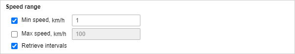

Speed range
Here in the Min speed and Max speed fields, you can the minimum and/or maximum unit speed required for the interval to be included in the report.
If you want the report to show only those periods during which the speed met the specified conditions, activate the Retrieve intervals option.

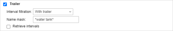

Trailer
The filter allows you to see the intervals within which a trailer or no trailers were assigned to the unit. The options in this filter work in the same way as the options in the Driver filter.

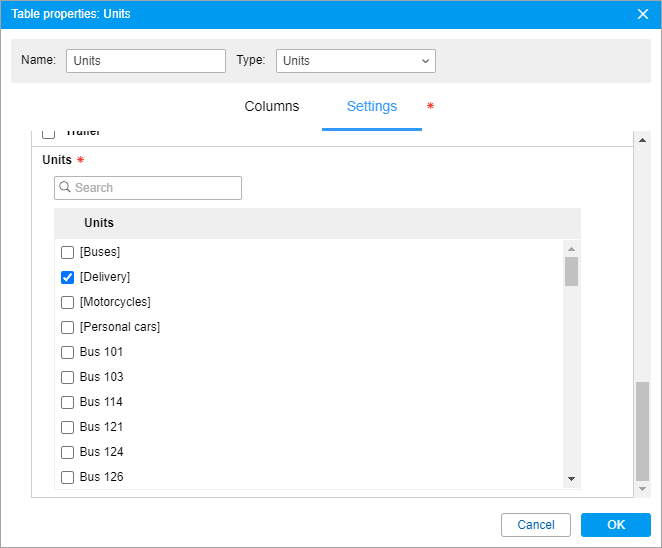

Units
This filter is used in reports on the assignments of passengers, trailers and their groups, as well as in reports of the Geofences and Groups of geofences types.
In the list, you can select units or unit groups which should be taken into account in the report.
