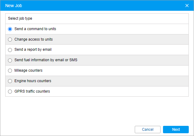

To create a new job, press the New button. In the dialog box that opens select the job type:
Then select units to apply this job to and set the basic parameters (activation time, schedule, and so on). In addition, for each type of job, adjust individual parameters described below.
