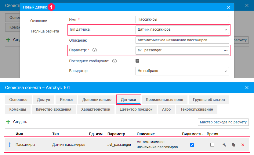

  1. For all the units, to which you want the passengers to be assigned automatically, create a sensor of the Passenger assignment type. The sensor parameter depends on the device you use and its settings.
