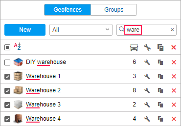

Dynamic search
If the list contains many items, it may be difficult to quickly find the required one. For convenience, you can use the dynamic search available on most tabs. Start entering the name of the object (geofence, unit, route, and so on, depending on the active tab). You can type just a part of the name. As you enter the text, the list shows the items that match your query. The search is not case-sensitive.
If you leave the filter field empty, all the available items will be displayed in the list.
You can also use the dynamic filter when adjusting the access rights on the Access tab of the user, unit, and unit group properties. Moreover, you can use the dynamic filter to select a resource when creating notifications, jobs, report templates, geofences, drivers, or trailers (as well as their groups and automatic assignment lists).
The usage of the dynamic filter on the Monitoring tab is described in the Unit list management section.
When searching, you can also enter special characters such as * and ? the usage of which is described below.

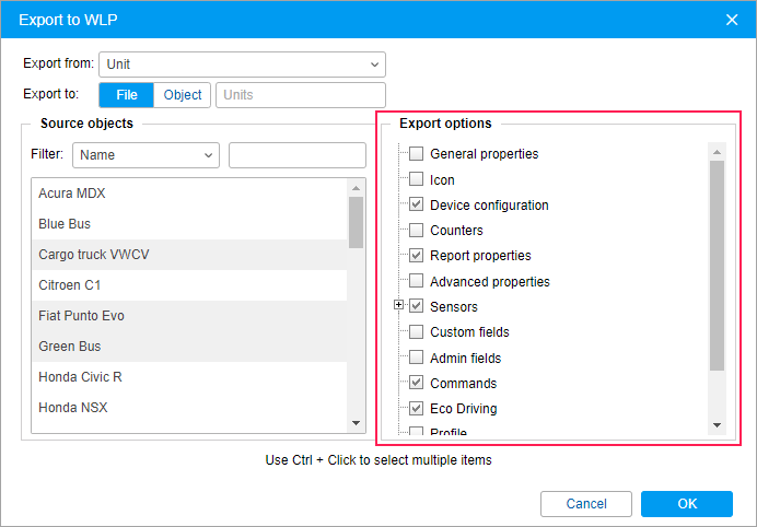

Checkbox list
Multiple selection lists may contain checkboxes indicating whether the item is selected or not. The Ctrl + click combination can be used in such lists in order to check/uncheck all the items at once.
