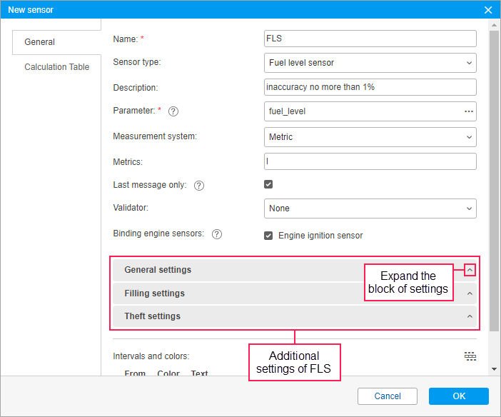

Additional Settings of FLS
The fuel level sensor has additional settings that are contained in three nested blocks: General settings, Filling settings, Theft settings.
