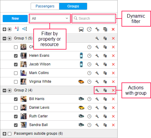

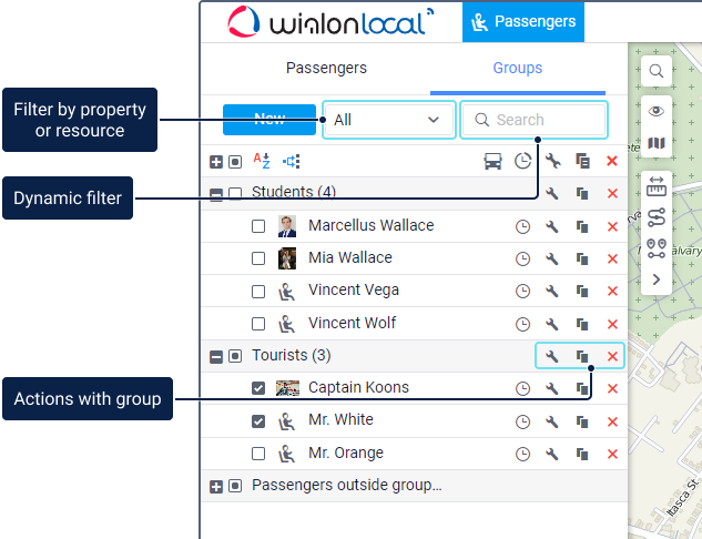

Managing passenger groups
By default, passenger groups are listed in alphabetical order. To switch between the forward and reverse alphabetical order, use the icon /. To quickly find the required passenger group, use the dynamic filter or the filter by property (assigned or not assigned passengers) or by resource.
Next to the group name, the number of passengers belonging to it is shown in parentheses. The passengers which don’t belong to any group comprise a separate group called Passengers outside groups. The tooltip of the group displays its name, resource, and the names of the passengers included in the group.
You can perform the following actions with passenger groups:
IconDescription
View or edit the group properties.
Copy, that is, create a new passenger group using the selected one as a template.
Delete the passenger group. The icon is inactive if you don't have the Create, edit, and delete passengers access right.
The passengers are not deleted as a result of deleting the group.
Expand the row of the group to see the passengers belonging to it and perform actions with them. To see the passengers from the group on the map, select this group in the list.
