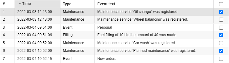

The table includes the following columns.
ColumnDescription
Time
The time when the event was detected (automatic registration) or registered (manual registration).
TypeEvent (traffic counter reset, events from notifications, some custom events, route control statuses), violation (violations from notifications, some custom events), maintenance (registered manually).
Event text
Event text which is taken from the text of notification or from the description entered while registering manually.
