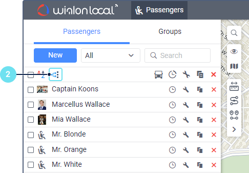

To configure the automatic assignment and separation of passengers, follow the steps below.
  1. For all the units, to which you want the passengers to be assigned automatically, create a sensor of the Passenger sensor type. The sensor parameter depends on the device you use and its settings.
  2. On the Passengers tab, click on the icon .
  3. Select the resource for the passengers of which you want to configure automatic assignment. To find out which passengers belong to a certain resource, apply filtering by resource to the list of passengers (displayed to the right of the New button).
  4. Click Next.
  5. Select the units or unit groups to which the passengers of the selected resource should be assigned automatically. To switch between the lists of units and their groups, use the icon /. For more information about the unit selection, see Creating jobs.
  6. Click OK.
The automatic separation of the passengers from the units is carried out in accordance with the algorithm described above.
To disable the automatic assignment and separation of passengers, click on the icon  , select the resource, clear the selection of the required units and save the changes.
