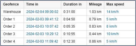

The Geofences table contains information about geofences visited by a unit.
When adding this table to a report, you must select one or more geofences in the table settings. You can use both the geofences from the resource in which the report template is created and the geofences from other resources to which the user has the View geofences access right. The resource is selected in the dropdown list above the list of geofences. You can also select the All option for the list to contain the geofences from all the resources to which the user has the necessary access right. The geofences in the list are sorted by name. To quickly find one, use the dynamic filter.
The Geofences table can include the columns described below.
Column Description
Geofence The name of the geofence.
Type Polygon, line, circle, unit (if units are selected instead of geofences in the report template).
Area The total area of the geofence (if the metric system is used, the area will be indicated in hectares).
Perimeter The perimeter of the geofence. The perimeter for a line is its length (line thickness is not taken into account).
Description The description of the geofence (taken from the geofence properties).
Time in The time when the unit entered the geofence.
Time out The time when the unit left the geofence.
Duration in The duration of the visit.
Total time The time from the beginning to the end of visit. It is recommended to use this column in combination with the grouping parameter or the Total row. If the Total row is configured in the table, it shows all the time that elapsed from the beginning of the first visit to the end of the last one.
