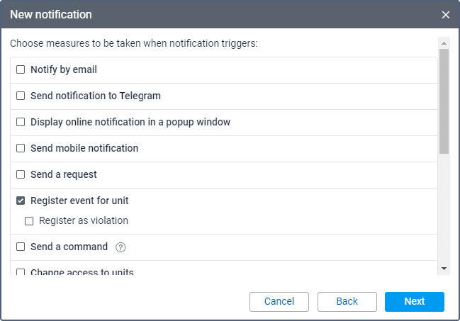

Register event for unit
This action allows you to register events in the unit history. To do this, the creator of the resource where the notification will be stored must have the Manage events access right to the unit.
The registered events are displayed on the Tasks tab and in the Events report table. In order for events to be registered as violations and to be available in the Violations table, enable the Register as violation option.

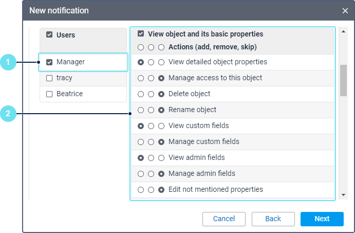

Change access to units
This action allows you to automatically change the user’s access rights to units. To do this, you should have the Manage access to this object access right to the user.
To configure this action, follow these steps:
  1. Select the users whose access rights you want to change.
  2. Next to the required access right, select one of the following actions:
  • Add. Allows you to grant the users this access right.
  • Remove. Allows you to remove from the users this access right.
  • Skip. Allows you not to change this access right.
This action can be useful when granting users temporary access rights. For example, the user should track the movement of a unit delivering cargo on a certain territory (geofence A). After the cargo is delivered to the required place (geofence B), the unit should be unavailable for this user. In this case, you should use the notification of the Geofence type.

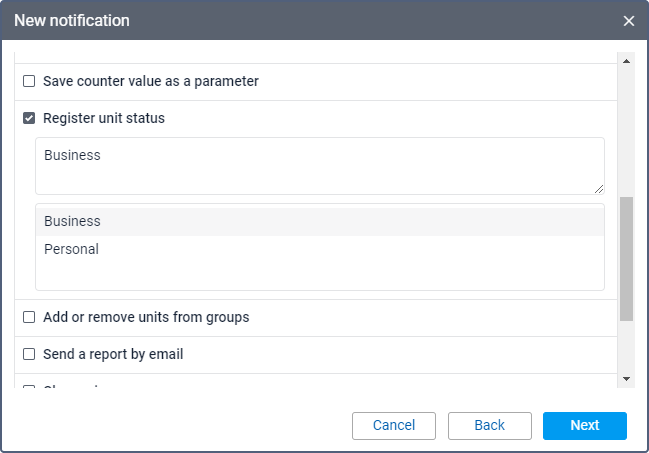

Register unit status
This action allows you to register the unit status: Business or Personal. To do this, you should have the Manage events access right to the unit. For example, when the unit visits a certain geofence, the unit status can be changed from personal to business or vice versa.
You can view records about registered statuses in the Events table.

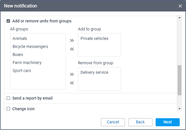

Add or remove units from groups
This action allows you to add or remove the selected unit from certain groups. To add the unit to the group when the notification is triggered, click on the required group in the All groups list and, using the icon , move the group to the Add to group list; to remove from the group, to the Remove from group list. To move the selected groups to the common list, use the icon .
Read more about the possibilities of working with this and other notification actions in the expert article.

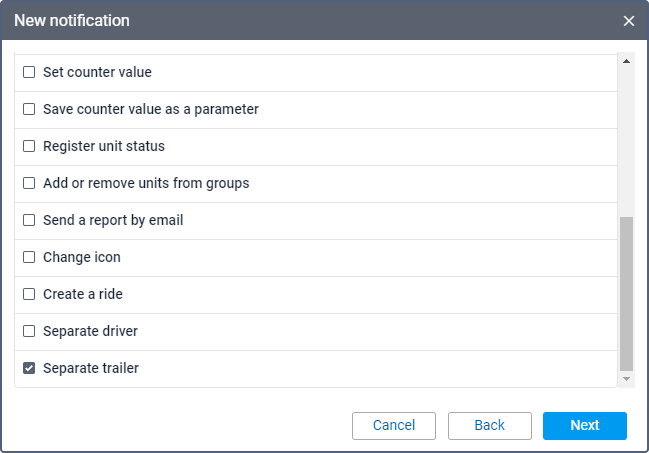

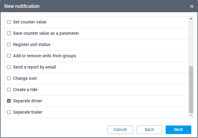

Separate driver
For this notification action, you should have the Create, edit, delete drivers access right to the resource to which the driver belongs.
This action allows you to automatically separate the driver from the unit. If several drivers are assigned to a unit, all of them are separated after the notification is triggered. The drivers and the notification should belong to the same resource.
See more information about the automatic separation of drivers.
Separate trailer
For this notification action, you should have the Create, edit, delete trailers access right to the resource to which the trailer belongs.
This action allows you to automatically separate the trailer from the unit. If several trailers are assigned to a unit, all of them are separated after the notification is triggered. The trailers and the notification should belong to the same resource.
