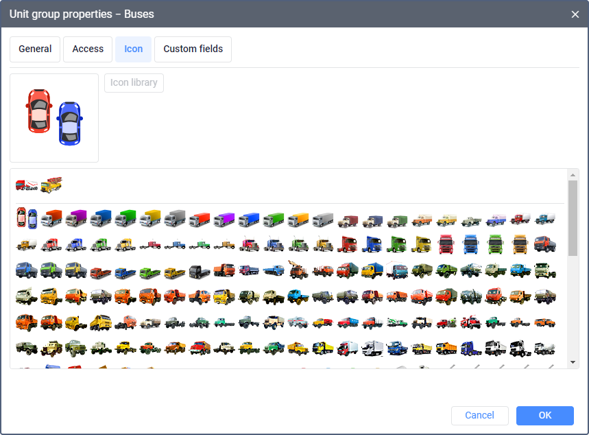

Icon
To view this tab and change the group icon, you should have the Change icon access right.
On the tab, you can choose an icon which should be used to identify the group in the lists of other groups.
You can use either standard or custom icons. To choose a standard icon, click on the Icon library button. To upload a custom icon, click on the chosen icon, select the image on the disk, and click OK. Supported formats are PNG, JPG, GIF, and SVG. The recommended image size is 32x32 pixels. To replace the icon with a standard one, point to the image and click on the icon .

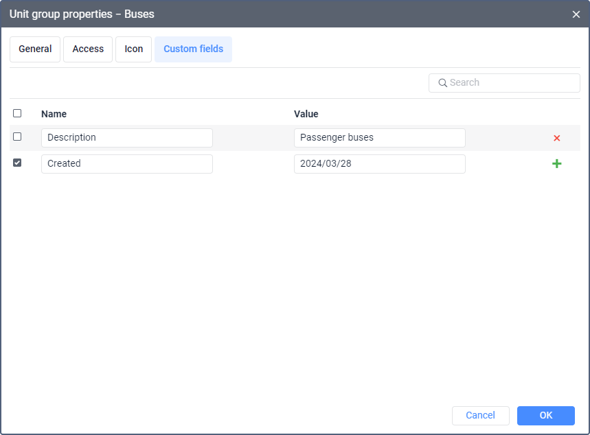

Custom fields
To work with the tab, you should have the following access rights:
  • View custom fields. To view general custom fields.
  • Manage custom fields. To create, edit, and delete custom fields.
  • View admin fields. To view administrative fields.
  • Manage admin fields. To create, edit, and delete administrative fields.
On this tab, you can create custom fields with additional information about the group or units added to it.
To create a custom field, fill in the Name and Value fields and click on the icon . The Value field is optional. After saving the changes on the tab, all custom fields are displayed in alphabetical order.
To restrict access to custom fields, you can make them as administrative. Thus, they will be available only to the users that have the View admin fields and Manage admin fields access rights to the unit group. Check the box to the left of the required field to make it administrative.
To delete a custom field, click on the icon   next to it.
