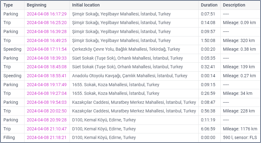

Chronology
The Chronology table gives information about all the actions and changes in the unit state during the indicated period of time. Unlike most of the tables that are dedicated to a particular state (parkings, sensors, trips, etc.), this table combines events of various kinds, which allows seeing the complete picture of the movement.
In the Data to display section of the template settings, select the information you want to see in the table: trips, parkings, stops, engine hours, fillings, drains, battery charges, events, drivers, trailers, speedings, connection loss, sensor trigger.
As the Chronology table combines data from several tables, it requires the same pre-configuration as these tables, and the same options are important for it. Below are the types of information from the Chronology table and their corresponding report tables with links to the documentation.
Type of information in the "Chronology" tableReport table
Trips
Trips
ParkingsParkings
StopsStops
Engine hoursEngine hours
FillingsFuel fillings and battery charges
DrainsFuel drains
Battery chargesFuel fillings and battery charges
EventsEvents
Drivers
Assignments
(Advanced reports service not required)
Trailers
Assignments
SpeedingsSpeedings
Connection lossConnection problems
Sensor triggerDigital sensors
In the Chronology table, you can select the columns described below.
ColumnDescription
TypeTrip, parking, stop, engine hours, filling (or reg. filling), drain, event (or violation), driver, connection loss, sensor.
Beginning
The time taken from the message that precedes the one in which the beginning of the given state was fixed.
In the case of fuel fillings, drains and battery charges, this column shows their time, that is, the time of the maximum fuel or battery level difference.
Initial location
The location of the unit at the initial moment.
In the case of fuel fillings, drains and battery charges, this column shows the location at the time they were detected, that is, at the moment of the maximum fuel or battery level difference.
End
The moment when the detected activity finished.
In the case of fuel fillings, drains and battery charges, this column shows the same time as the Beginning column.
Final location
The location of the unit at the final moment.
In the case of fuel fillings, drains and battery charges, this column shows the same location as the Initial location column.
Duration
The duration of the state.
In the case of fuel fillings, drains and battery charges, this column shows 0 because the system doesn’t calculate their duration.
DescriptionFor trips and speedings — mileage, for events and violations — the text of notification, for engine hours — duration, for drivers — driver's assignment/separation and name, for fuel fillings, fuel drains and battery charges — the volume of fuel (amount of energy) and sensor name, for sensors — sensor activation/deactivation.
If you want the Cronology table to contain information about triggering of only certain sensors, you can configure the Sensor masks filter in the table settings. The Chronology table can only show information about sensors from the Digital group.
The Chronology table may show rows with fillings and drains marked as false. To do this, the Show false events option must be enabled in the report settings.
The system does not calculate the duration of the state for fuel fillings, fuel drains and battery charges. Therefore, the beginning and end time for fillings, drains and charges, as well as the initial and final location coincide in the Chronology table, and the duration column displays zero value.

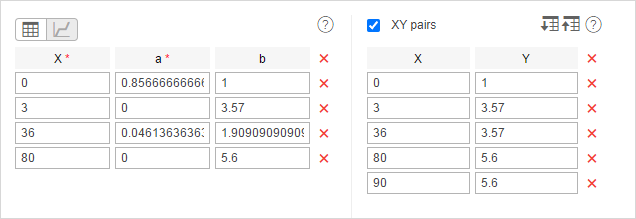

How to determine fuel consumption, if I know how much fuel the unit consumes within the city, and how much outside it?
Let us suppose that the fuel consumption in the urban cycle is 10 l/100 km and 7 l/100 km — in the suburban cycle.
  • Create an ignition sensor (as in the example above) and set 1 l/h for the consumption during idling.
  • The average consumption in the urban cycle is 36 km/h, in the suburban — 80 km/h.
  • The unit will cover a distance of 100 km driving at a speed of 36 km/h in 2.8 hours. 10 l / 2.8 = 3.57. Let us calculate the value of the increasing coefficient when moving in the city: 3.57 / 1 (idling) = 3.57.
  • As a result of a similar calculation for the suburban cycle, we obtain the coefficient equal to 5.6.
  • Create an engine efficiency sensor, taking into account the fact that the unit cannot consume less fuel than during the idling, and that it is stationary before the beginning of the movement. As a parameter we use the average speed (speed + # speed) / const2 and fill in the calculation table (manually or using the calculation table wizard):
Note that the last pair of points is how the system calculated before (the fuel consumption was considered constant for a speed above 80 km/h). You cannot use this method and change the set of points. Also ‘3’ in this example is the minimum speed from the unit’s trip detector, consequently, this parameter can be different for your unit.
Result: in our example, the average consumption has been calculated for the unit. It has been calculated relative to the speed and time between messages and taking into account the values of the vehicle operation.
