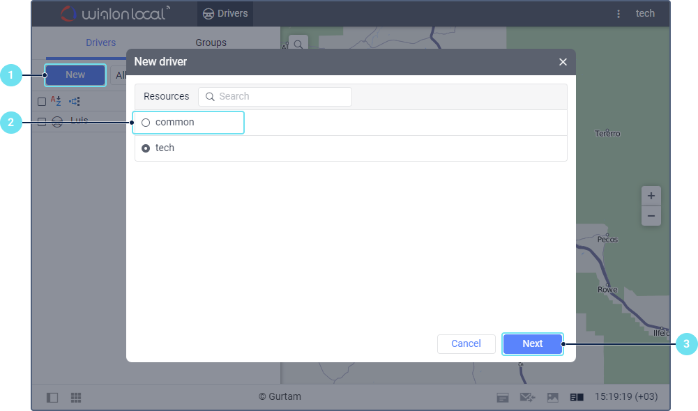

To create a driver, follow these steps:
  1. Click New on the Drivers tab.
  2. Select the resource in which you want to create a driver if you have more than one resource available.
  3. Click Next.
  4. Enter the driver name and specify other required properties.
  5. Click OK.
After saving, the new driver is shown in the list.
